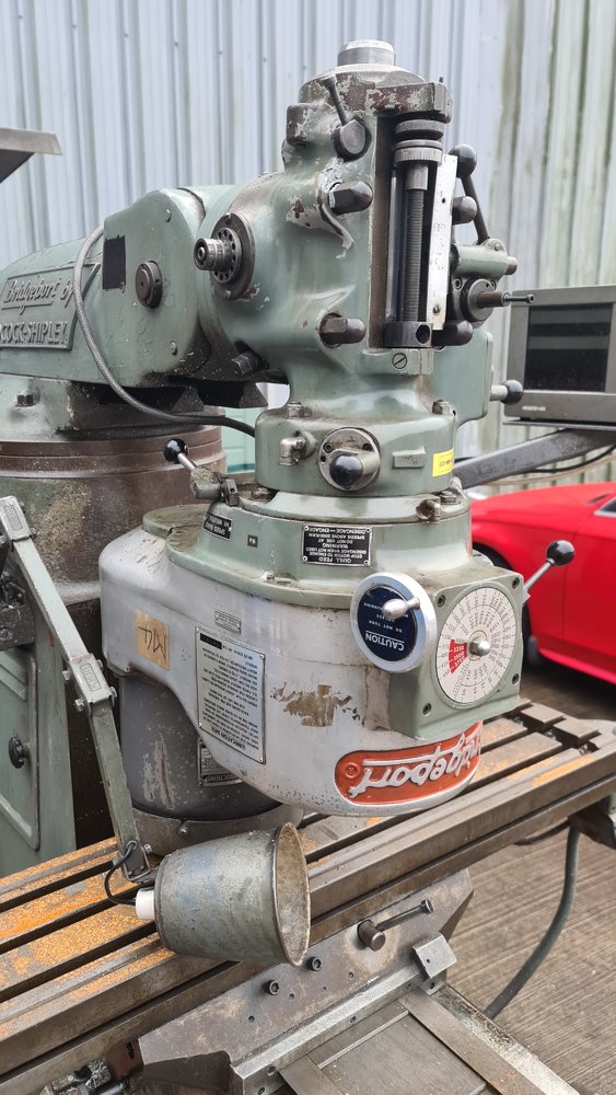

I have said it many times in the past but most damage is caused by poor packing.

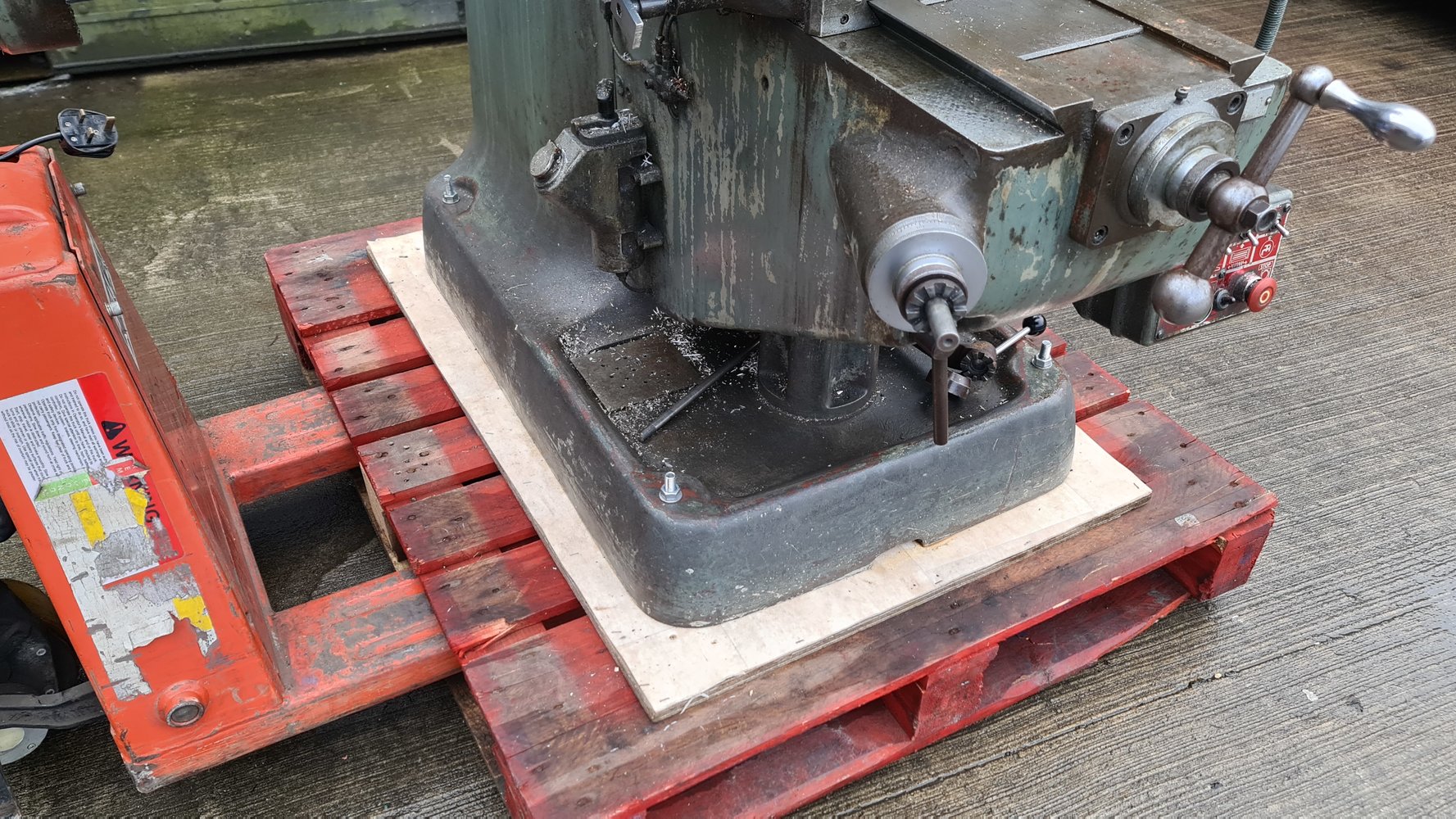

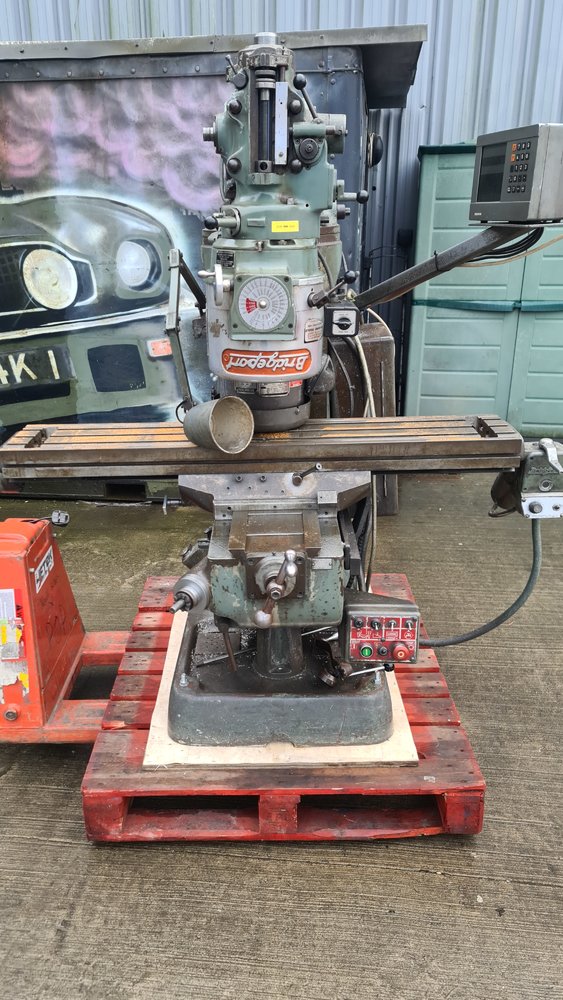

Here is how I palletised a Bridgeport for a customer. I collected myself. Forklift at collection and at my warehouse. Will travel through our network for delivery as needs a tail lift.
Notice the head upside down. Makes it far more stable.
Hardest part was getting the domed head coach bolts up from under the pallet. Domed head underneath to avoid fouling the forks.
