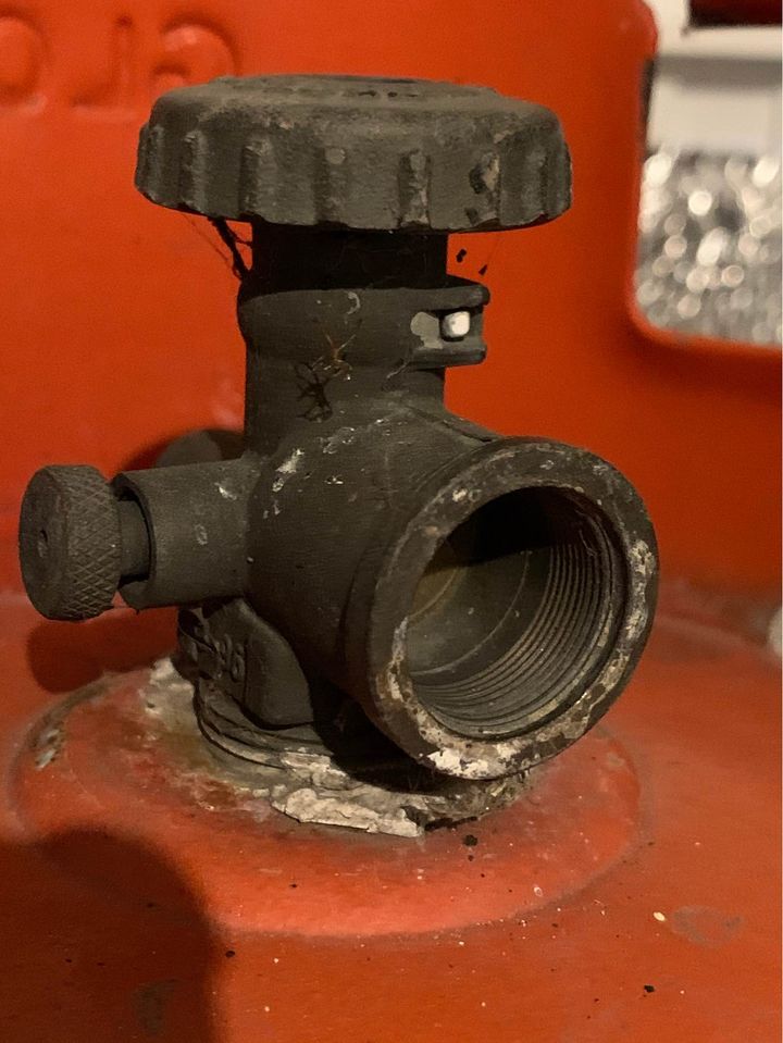

winchman Member Messages 6,358 Location Merseyside May 24, 2021 #1 Any one know why this propane bottle has a slightly different fitting?
gaz1 Member Messages 20,540 Location westyorkshire May 24, 2021 #2 its a purge valve takes the pressure off the system before you disconnect the pipes handy when theres no access to the caravans
winchman Member Messages 6,358 Location Merseyside May 24, 2021 #3 So it would be ok to use on a caravan? Just never seen one
Kayos Gone...... Messages 9,724 Location North Lincolnshire May 24, 2021 #4 If the POL fitting screws in you will be good to go. What size bottle is it? Boilers need a 47kg as the smaller ones don't have a big enough take off rate
winchman Member Messages 6,358 Location Merseyside May 24, 2021 #5 I think its about 11-15kgish from memory. The caravan only uses a small amount
Kayos Gone...... Messages 9,724 Location North Lincolnshire May 24, 2021 #6 Is not the amount, its how quickly it comes out of the bottle
