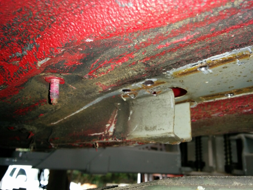

I'm now onto my second rolling chassis. The first (a black 89 model) sat outside for far too long, deteriorated in the weather and suffered vandal damage to some panels. After steam cleaning the mould off and putting it on the hoist, I decided it was going to be far too much work and I'd be better off looking for another one with less rust and panel damage.
