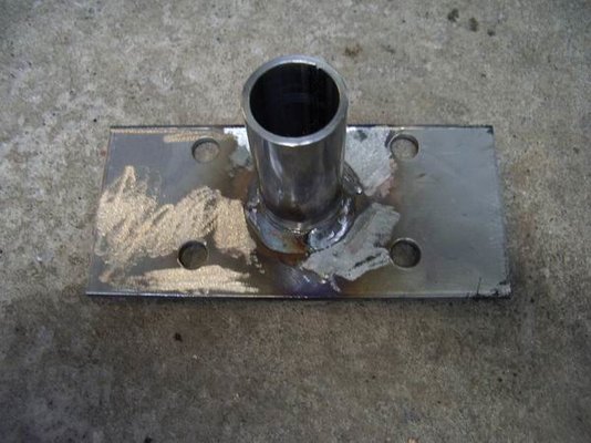

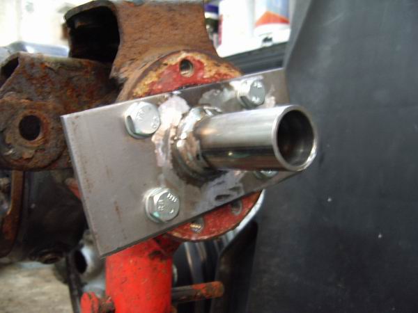

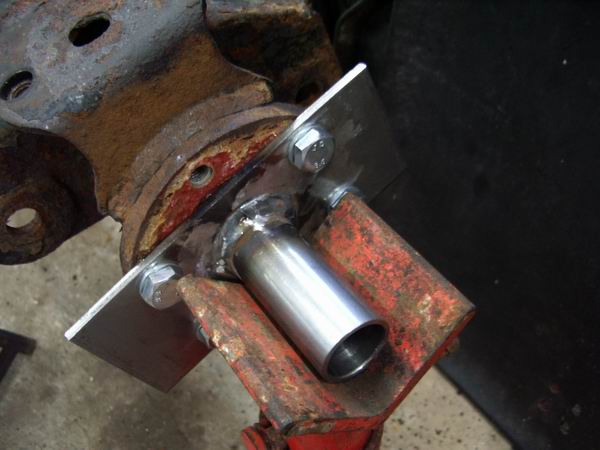

Stripped the hubs / swivels off my Range Rover axle the weekend and wanted to clean & paint the axle casing while overhauling hubs.
Recalled the "spit roast" ideas so found some tubing similar to that used to make seat frames at work
and welded to some plate used to "trade test" production welders.
Bolted onto axle casing
Now pivots on axle stands
Can now turn axle to reach all of it with ease + bonus is plate blocks hole to keep dirt out!
