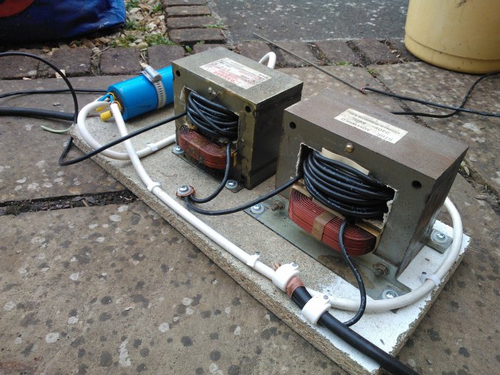

Figure most will have read about these, but they remain a good simply project. Mine is up and running, and I estimate its aroud 150 amp at the mo, It is without a case, and glitter. But it works and its strong
I have still to fit a cooling fan, and am contemplating a third transformer, in case I ever have to work on the ark royal.!
So far only hitches with build, was matching phases on 2 transformers.
There were 2500v at 0.8amp. After re-winding the secondries, its around 50v 140-150 amp. doesnt arc up great, but when it starts, is wicked.
