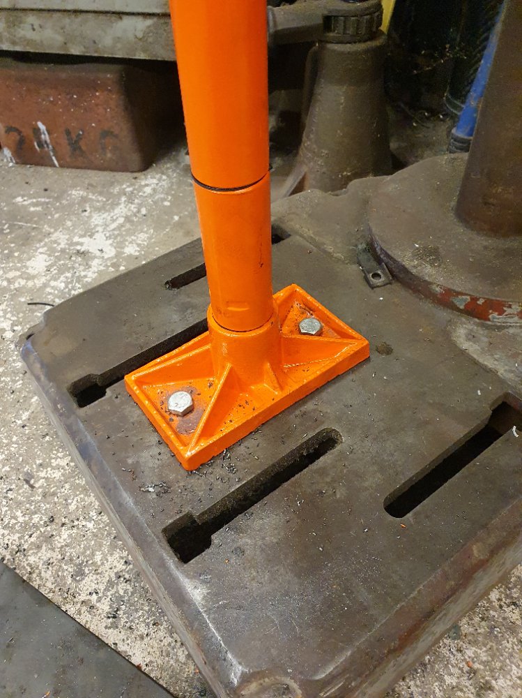

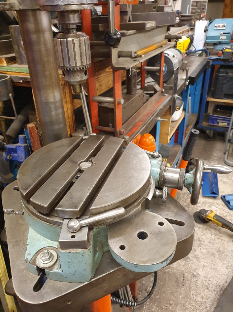

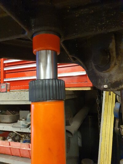

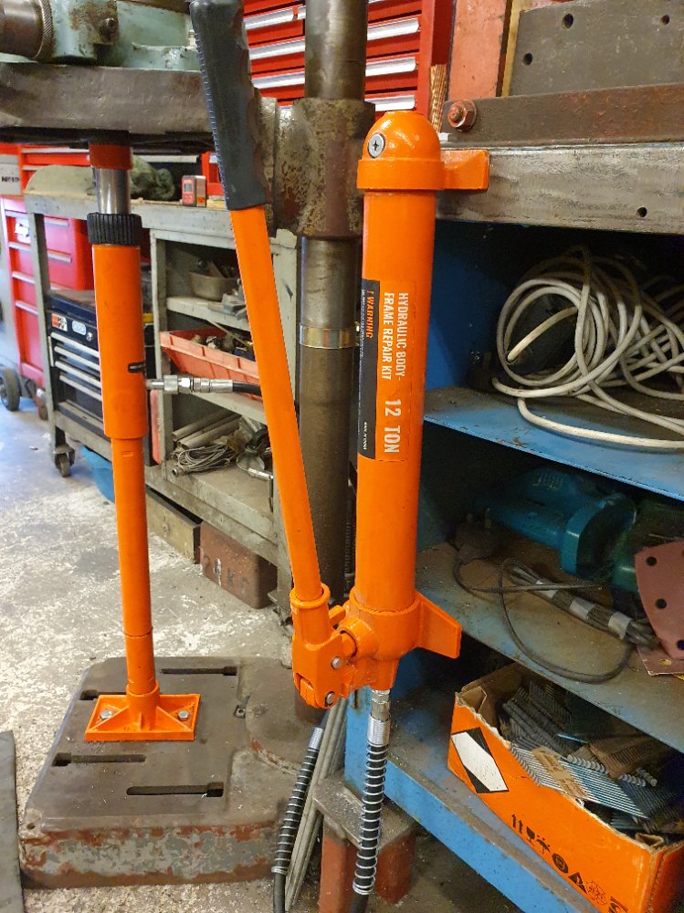

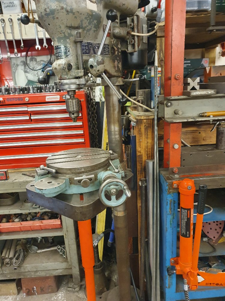

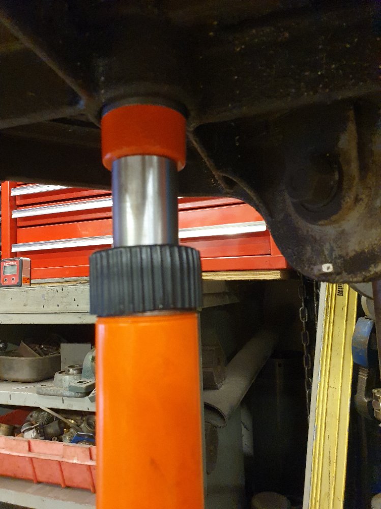

The old Progress i have does not have a rise and fall ratchet which has not been a problem, after mounting my really heavy roatary table its now impossible to lift or lower. To overcome this i have fitted my ram to it and its made it a nice machine to use again plus has the benefit of giving the table some support instead of it hanging off the cast bracket on the pillar.
