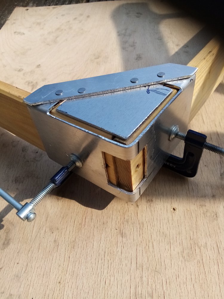

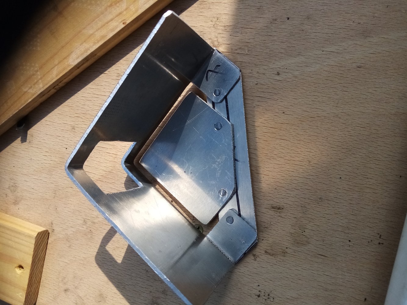

Have you checked it's actually 90 degrees ?I've got a workshop base to set out for a friend. It will involve setting some profiles up. So to save a bit of time and hassle i made this jig to aid screwing them together. Keeps everything nice and square. View attachment 459177View attachment 459178
Aye......Well its near enough for pit work!Have you checked it's actually 90 degrees ?![]()

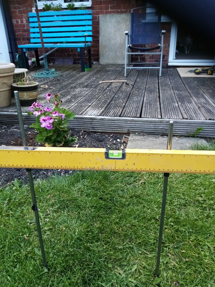

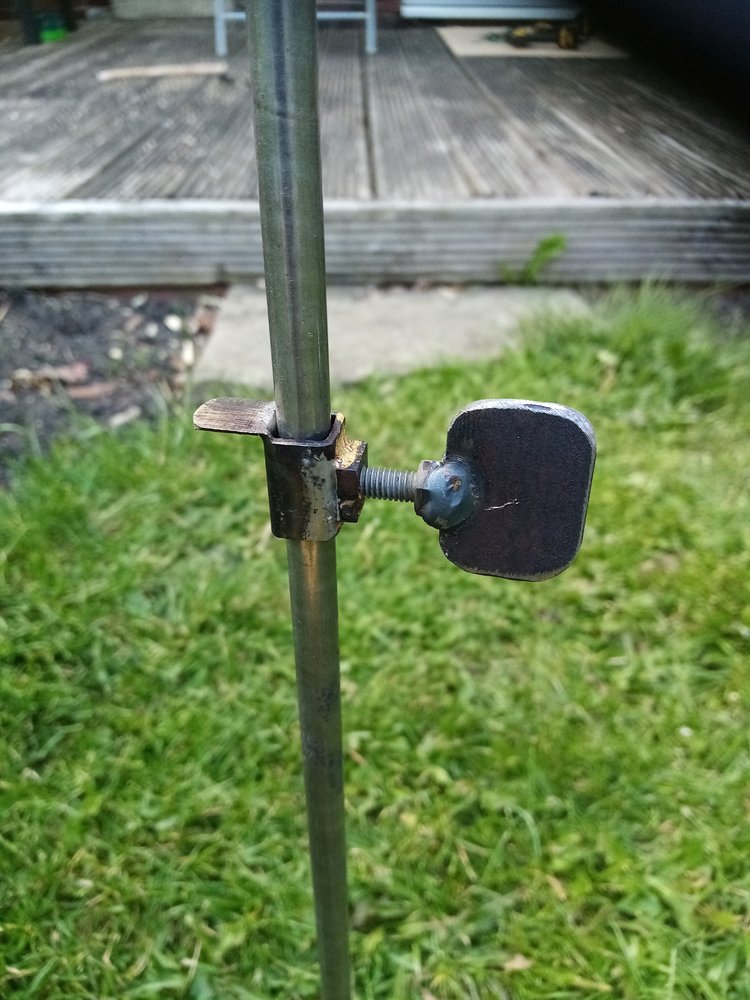

Very clever ideaI made some of these adjustable stops to fit on my pins for transferring heights/levels. The pins are 10mm bar and the stops half inch box section with a 6mm nut brazed on. All out of the scrap at workView attachment 459192View attachment 459194
This was a complete white elephant. It can now reside in the heroic failures pile. Oh well you live and learn. The rest went swimmingly.I've got a workshop base to set out for a friend. It will involve setting some profiles up. So to save a bit of time and hassle i made this jig to aid screwing them together. Keeps everything nice and square. View attachment 459177View attachment 459178
