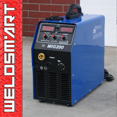

Have an 200 Amp Gas/gasless welder, el cheapo machine, with only wire speed, two switched, for Power (min or max) and the other switch is 1 or two (http://virtualhardware.com.au/images/cart/products/mig200welder-image.JPG)
Any tips on settings will be appreciated, don't want the metal cancer to come back like previous work has, paint cracked, rust everywhere.
