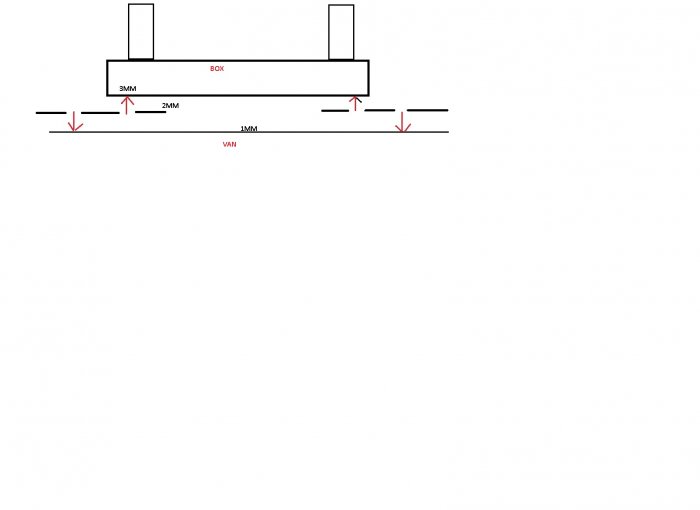

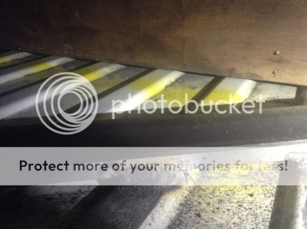

Now the problem arises when I try and weld said bracket to the floor of my van. The box section is 3mm thick, and the floor of my van I guess 1mm. The box section is rounded so there is a small gap between surfaces.
What happens is, when doing a uuuuuuuu pattern, the weld sticks to the box section, and sticks to the floor of the van, but not in between (until I go over it again)
Sometimes the wire will extend into the gap and stop the molten flow
The area is prepped, I am earthing the box section. The welder is on heat setting 4 (out of 6) and the speed is just past 12 o clock.
If I try and go slower I just burn through the floor, tried all different settings and all to no avail.
