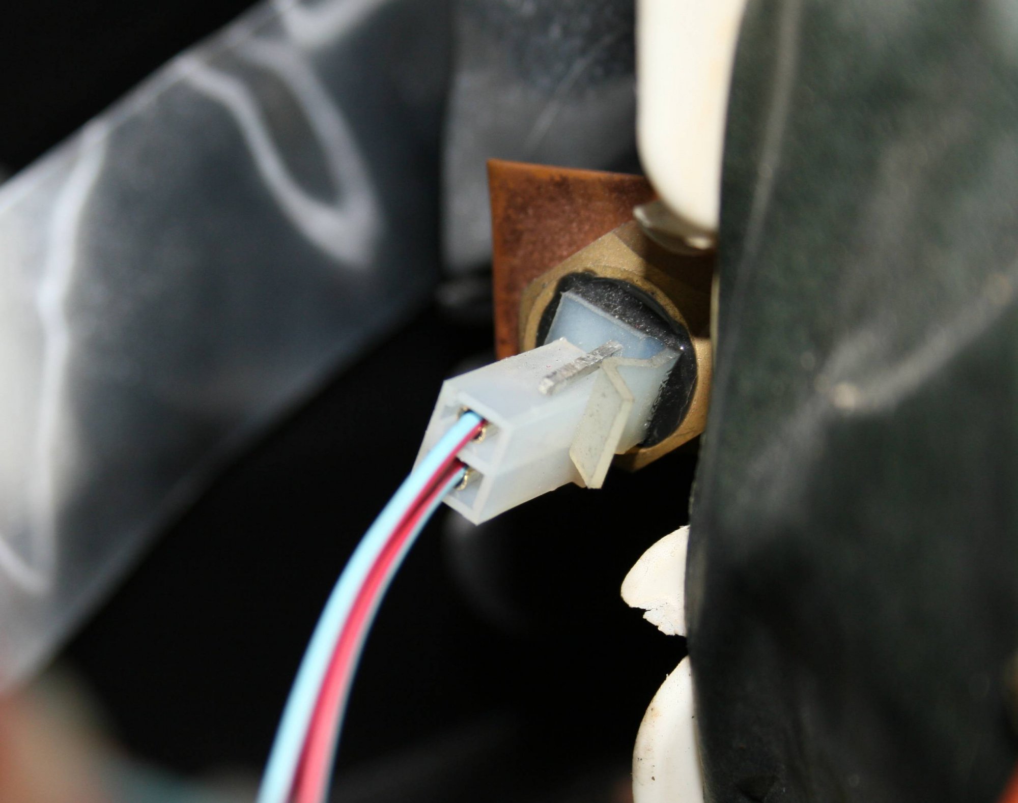

Hello, i've just pulled my 135AT out of my van which has been sitting idle for a couple of years. When I put the welder in it was OK. tried to fire it up today, no spark. pulled the 'old' section of wire through, still nothing. Open the casing to look for loose connections etc. What I did notice however is that what looks like a thermostat on the transformer, the connector plug which has 2 wires, only half the connector is plugged in. It hasn't fell out because it has a locking groove. I didn't want to alter it and reconnect fully incase it shorts anything.
Does 1 wire to the thermostat seem right?

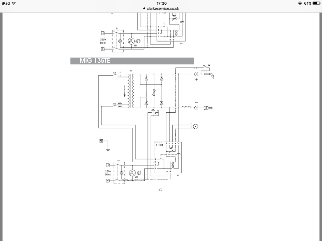

I've been looking around for a wiring diagram, but not been successful yet.
