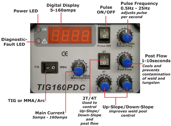

I have a R-Tech TIG160 and have been successfully building bicycles on and off since 2011 however today things have changed ?
Not touched the welder for maybe 6 months and have a newly filled bottle , cannot remember if I used it ok before I stopped welding ?
Came to weld some joints today same steel as always , cleaned in same way and tungsten sharpened on planisher as usual.
There seems to be no power in the arc no matter how high I turn up the current ?
I had a 1/16th tungsten @ 115 amps and found I could touch it down on the work and it would not make a weld pool or stick to it ?
I am indoors now however I am sure I check all three switches were down ie. 2 way , Pulse off , TIG mode.
I tried the earth in 3 different places and checked the flow at the torch and upped it to 10 l/m still no difference ?
Bottle shows <200 psi.
I am sure I have overlooked something simple ?
regards Paul

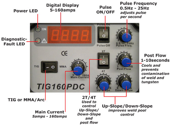

regards Paul
