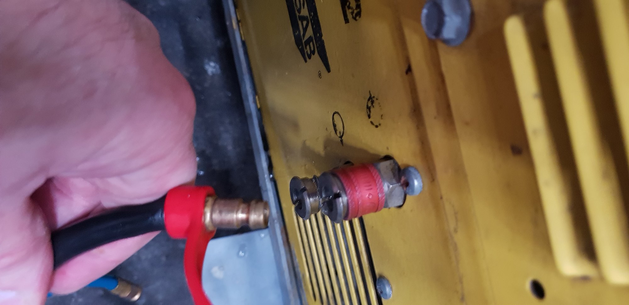

Youve probably tried already.... pull the collar back on the female connector, then push the hosetail in and release...?
The fittings on your torch are rectus 21 just buy two new ones for your cooler to suitYes. Just won't go in far enough.
One of the collars has now split into 2 parts gggrrr.
Search eBay for rectus 21 you will have to unscrew the front panel of your cooler to replace themAre these easy to find and fit?
Change the cooler ones as they are old the o rings will probably be perished in them anyway and I believe it's a 8mm barbCheers - now have to find out if 6mm or 8mm.
Would t be easier to change the torch ones? Or as the locking collar is knackered then perhaps better change on the cooler.
