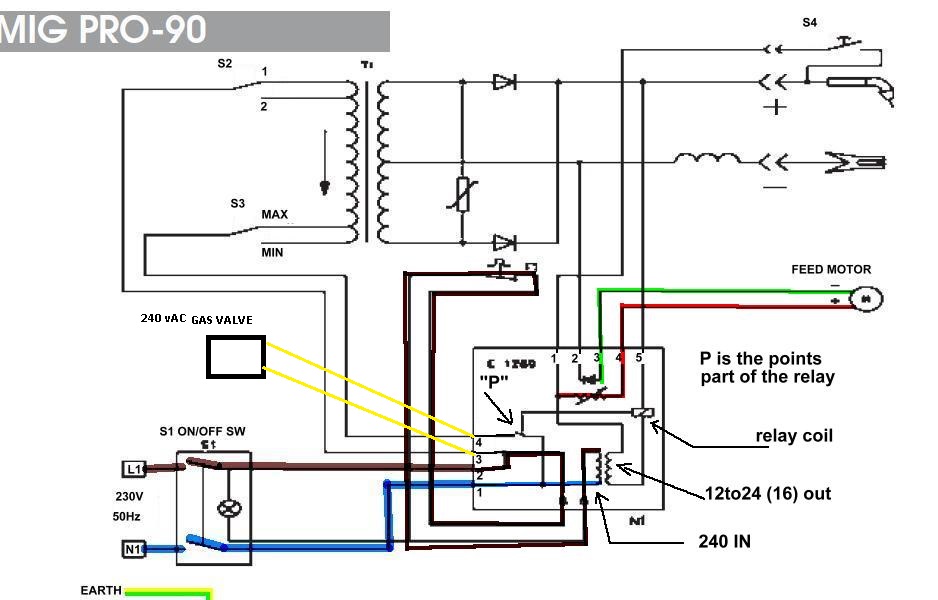

New to this site so forgive me if this has been covered in another post but I have got a problem with my pro 90 mig.
I have had this welder for about 20 years (yes thats right 20 years) bought it when i left school when i was training to be a motorcycle mechanic and have used it loads over the years until recently.
started welding some steps for my perants caravan and just couldn't get the weld right thought it was me at first then the feed kept stopping and the filler wire started glowing and there was a humming noise, couldn't get it to arc up properly to melt the wire. the feed motor runs ok until you ground the electrode wire.
I have changed the liner, the electrode tip and gas shroud. I have also put a new spool of wire on just in case the wire was coroded but still the same.
Would be greatfull for any replies feels like ive lost an old friend
