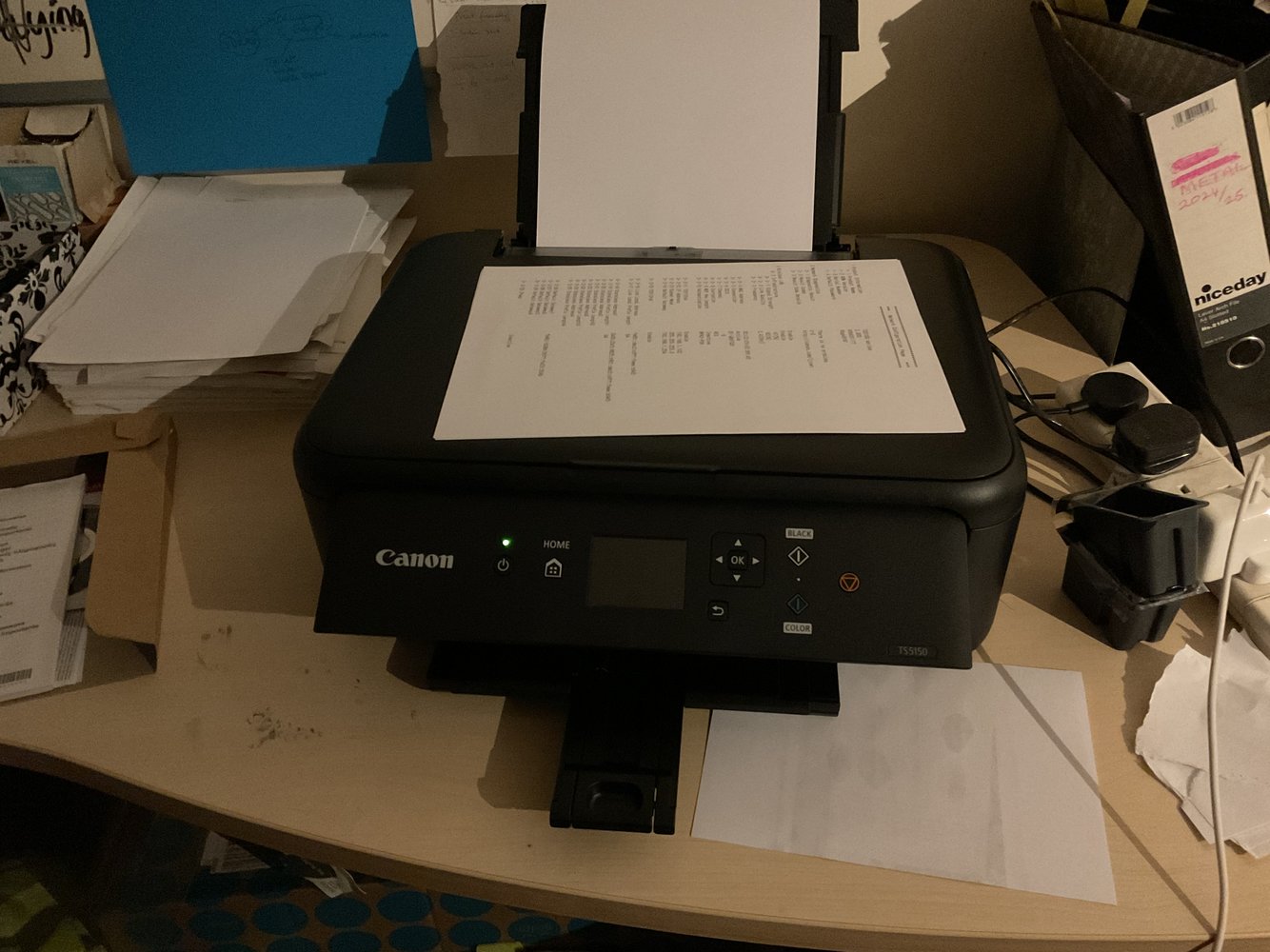

Just any inkjet printer that does not refuse to print if the cartridges have been refilled after registering as empty. I use a Canon Pixma because it was thrown as "free" in a deal for some AV gear, it has printed at least 15 reams of paper and still soldiers on. I buy black ink in 200ml bottles from a German company by the name of Octopus, its cheap, good quality ink and it takes me about 5 minutes to refill a cartridge from removal to refitting, €26.70 cheaper than €27 for a new OEM cartridge. No my hands don't get covered in ink, syringe with a needle included with ink order, disposable poly gloves from the petrol station.Need a new one,budget £100, then there’s the ink cost ,as that’s possibly increased more as you can’t always just buy black,of course I rarely use colour,with our old one I forget a cheap source on e bay.TIA.

Useful thanks,which model pixma,what ink cartridges,are they single colour or colour all in one,do you poke the syringe in anywhere at the top?Just any inkjet printer that does not refuse to print if the cartridges have been refilled after registering as empty. I use a Canon Pixma because it was thrown as "free" in a deal for some AV gear, it has printed at least 15 reams of paper and still soldiers on. I buy black ink in 200ml bottles from a German company by the name of Octopus, its cheap, good quality ink and it takes me about 5 minutes to refill a cartridge from removal to refitting, €26.70 cheaper than €27 for a new OEM cartridge. No my hands don't get covered in ink, syringe with a needle included with ink order, disposable poly gloves from the petrol station.
The print head life is a "mileage may vary" parameter, I keep the printer in a cleanish area, I think perhaps 15 refills before I notice streaks of faintness that a nozzle clean does not remedy, some report less, very few report more than that.

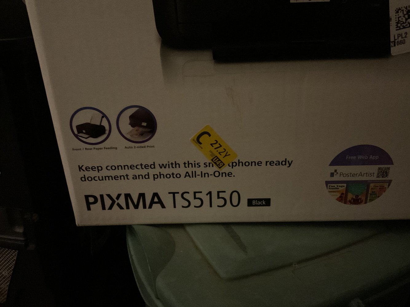

Pixma 5151. Black seperate cartridge. Colour, cyan, magenta, yellow in the same cartridge. There is always a moulding spot underneath the label to locate where to pierce. A small drill bit, I use a 1mm drill in a pin chuck but a small cordless or even a bench drill would work, the plastic of the cartridge is not thick, a small piece of insul tape over the hole after.Useful thanks,which model pixma,what ink cartridges,are they single colour or colour all in one,do you poke the syringe in anywhere at the top?
