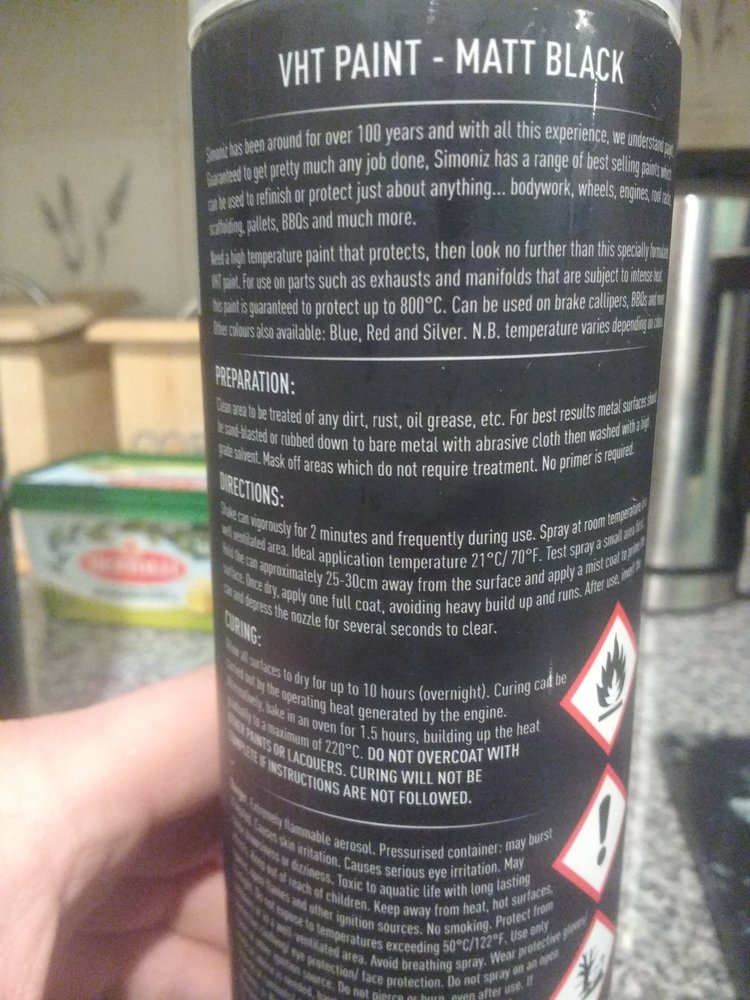

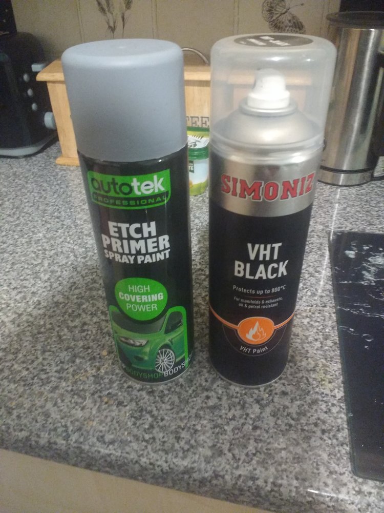

I didn’t like to say but…. Yeah.I used Simoniz on a small steel part, it was absolute rubbish and came straight off...
The part was clean, dry and grease free so not my fault!
Interested to find a decent rattle can hi temp paint that stays on..

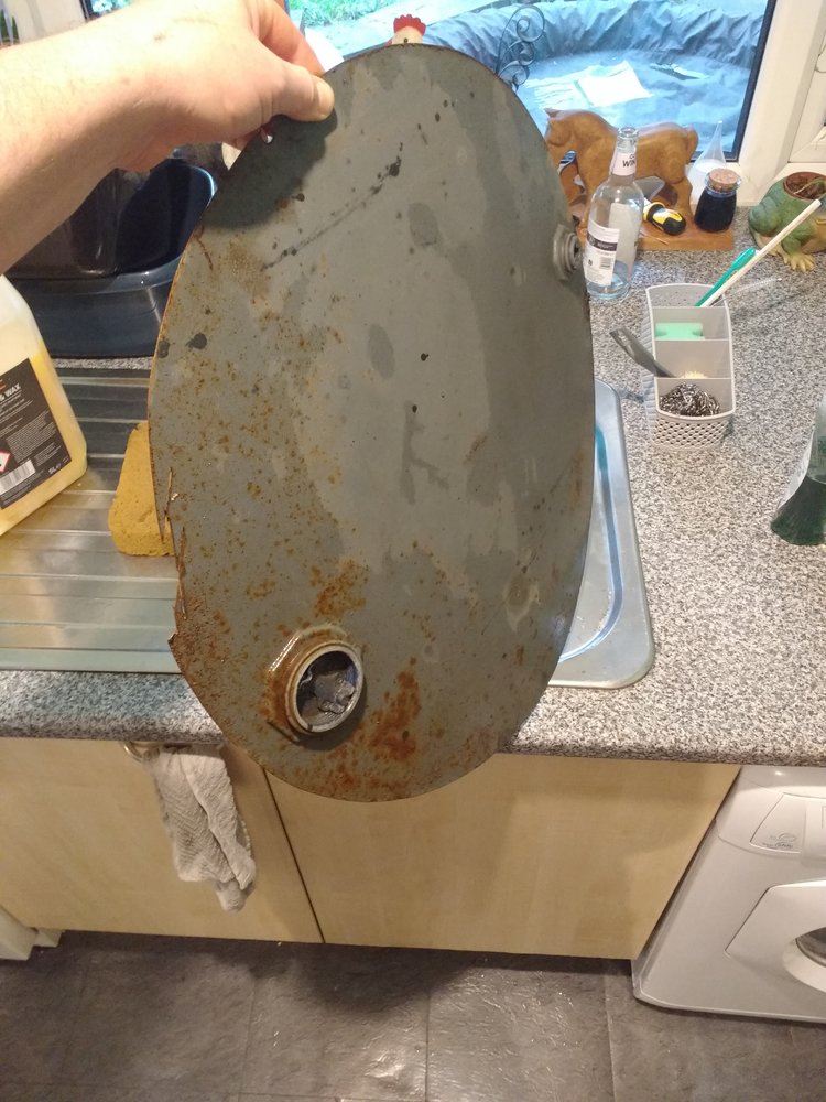

Heat? Like a torch if possible. Get it gummy then scrape it off?One side of this old oil drum is painted blue and it's quite thick & rock hard. Can't find my liquid paint stripper even.

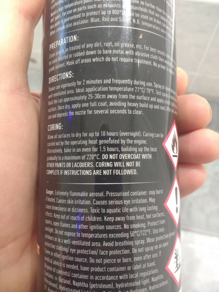

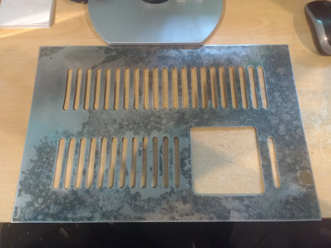

That came out alright.That baked off quite nice I think. As for its longevity we shall have to see!
Not too shabby considering it's origins:
Did you get in trouble for the curing process?
I would have done.
