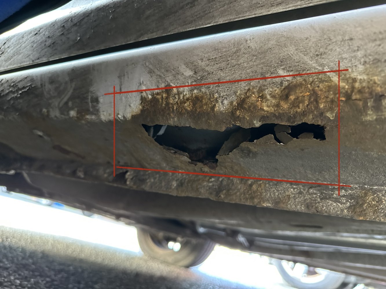

Yeah I know he put the box on trying to be funny it's more of a joke between us so I don't miss anything obviousFirst thing,
Don't work out the price based on the area of that red box.. that's not big enough..
Ditto. I hate welding on cars. “Sorry I’m not insured for that”In my experience of welding on cars. It's think of a price, double it and add a zero on the end. And after that you will still be working for less than £5 an hour.
Yup ^^^ I've sandblasted only a few times for money (even then, they were friends, no customer off the street)In the case of a hole like that it’s an iceberg.
Never mind the inner structure . .That hole in the sill pictured above, would probably extend up to within 1" of the edge, (it's already down into the pinch weld) and probably 3/4 of the length of the sill.
I was referring to only the outside sill.Never mind the inner structure . .
If you can be bothered, and most including me rarely can (better things to do) showing a mate or customer that sort of breakdown almost always results in a "I had no idea!" reply.Price varies massively based on the quality of the repair the customer wants,
Mot worthy with a 1yr warranty:
New sill £100
Cutting discs, grinding discs, sanding belts wear & tear on the tools, £30
Remove & prep 2hrs
Fit up and adjust 1/2hr
Use of clamps/welder £30
Wire/gas £20
Weld up and rough finish 1hr
Clean off consumables £15
Scotch up, mask and paint 1hr
Rattle can Primer £15
Rattle can Stone chip £15
So that's £225 + 4.5hrs Labour. Round it up to 5hrs for getting stuff out and putting it away.
£30 hr? = £375.
I'd call that cheap "mates rates"
If it's an mot failure the car is worthless without the repair and £500 would be the sort of money I'd want to crawl around on the floor doing the job in the first place.
