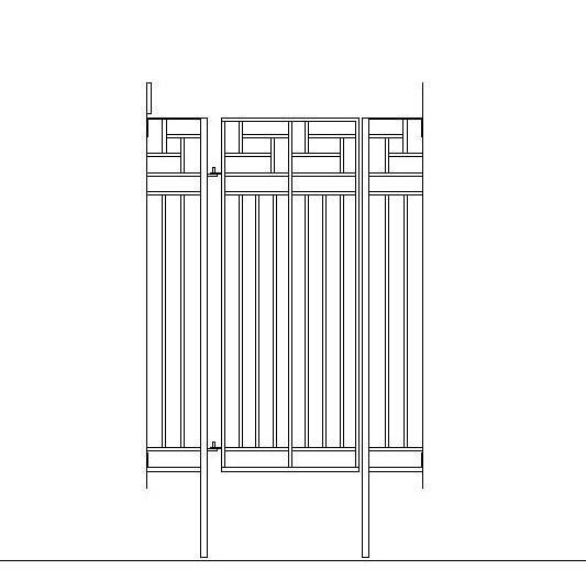

Cash job, id be pricing at £350 painted.
Try and get them to have it unpainted, at £250.
I always overprice stuff if they want it painted, i hate painting!!
Im lucky to have access to machinery that makes things easy. Most of the box could be cut in only a few cuts, theres lots of bits the same length, stack cut them to save time if you can.
Make the gate first, then use that as a jig for tacking up the side panels.
Do most of the welds downhill, and face ones in the flat. Only one turn required.
I could bung that out in about 3 hours unpainted. £30 to cover odds, £40 p/h. not bad.
As mentioned above though, its all down to the gear you have, and partly your own skill.
Can you work fast and still get it right?
I have done jobs for myself before, where its taken twice as long as expected. You win some, you loose some. If all goes really badly, £5 p/h is better than nothing if you dont depend on it for anything other than beer money.
Whatever happens, youll never make as much as you can drink in an hour
