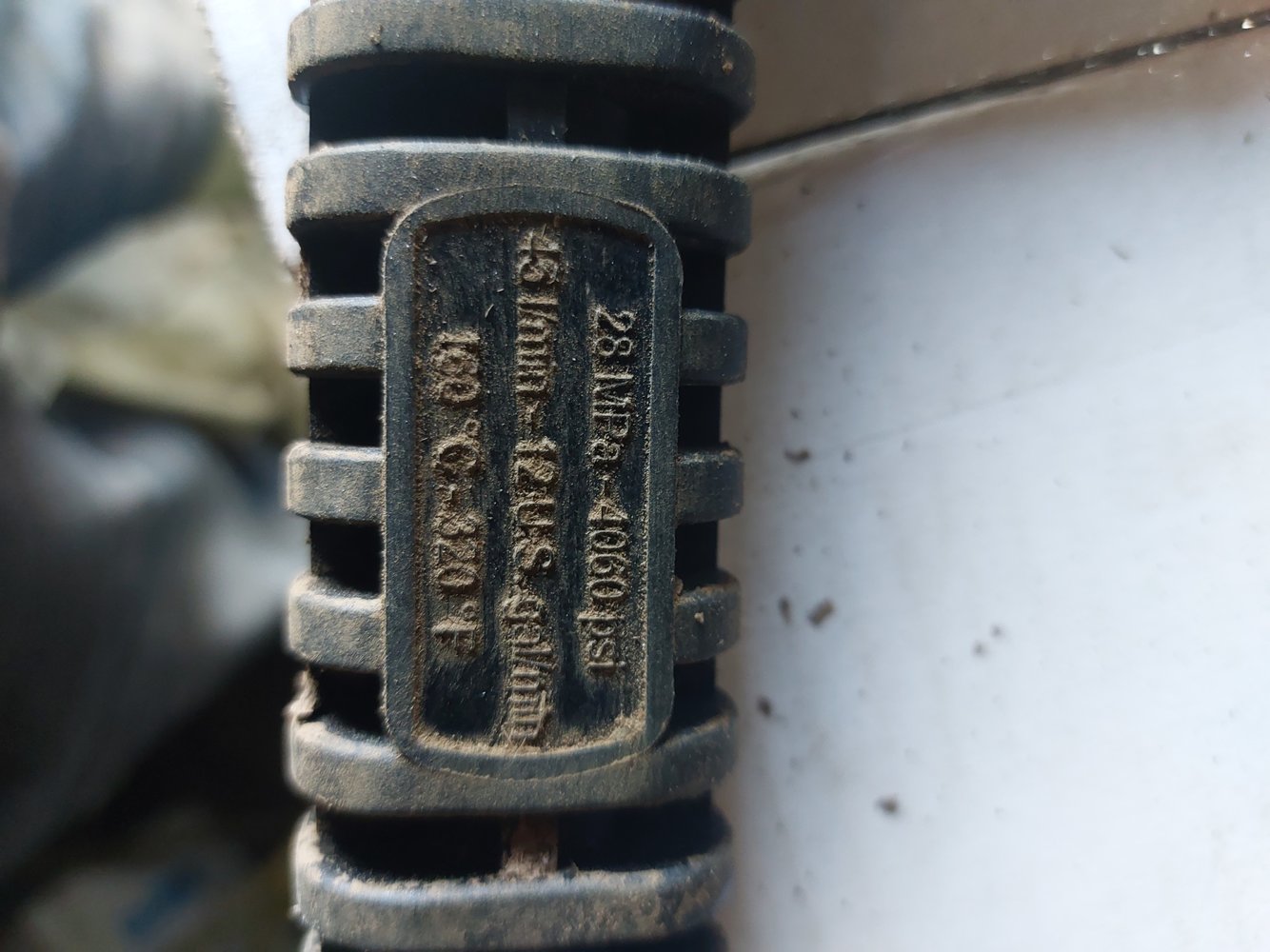

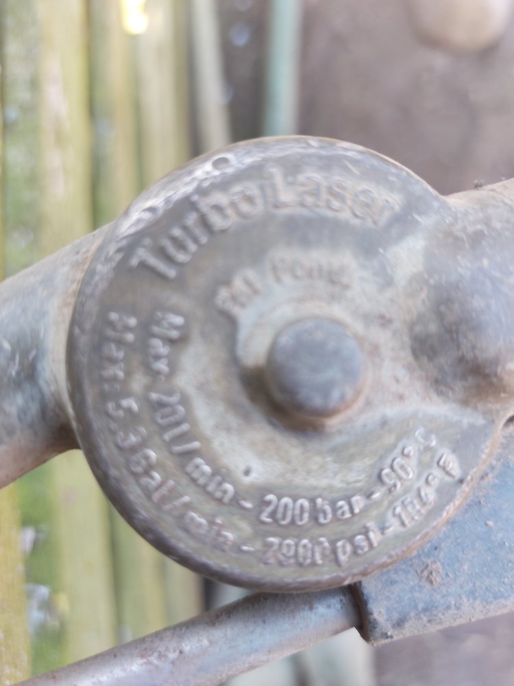

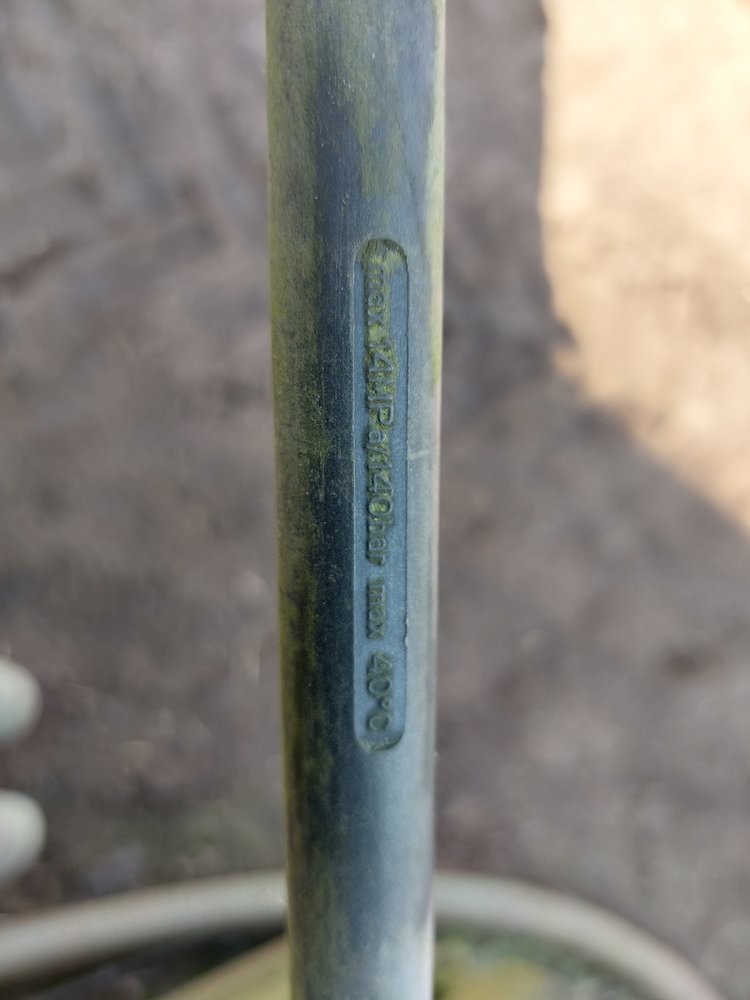

I’ve a LAVOR hot pressure washer which is a lovely bit of ‘compact’ kit. I’ve swapped the extension over on my lance for the ones on eBay that are sectional and just about reach anywhere with any angle necks. They are the type with interchangeable ’coloured’ nozzles for different angle width jets. The tube is narrower and after using it today on a continuous clean the machine stops dead and resets itself after a short while. I can only think the pressure is too much either in the diameter of the stainless pipe or the nozzle hole as with this set up I can feel an awful lot more power at the tip. When I put the std lance end back on its fine and causes no issues. Anyone played about with pressure regulators or whatever they have?
