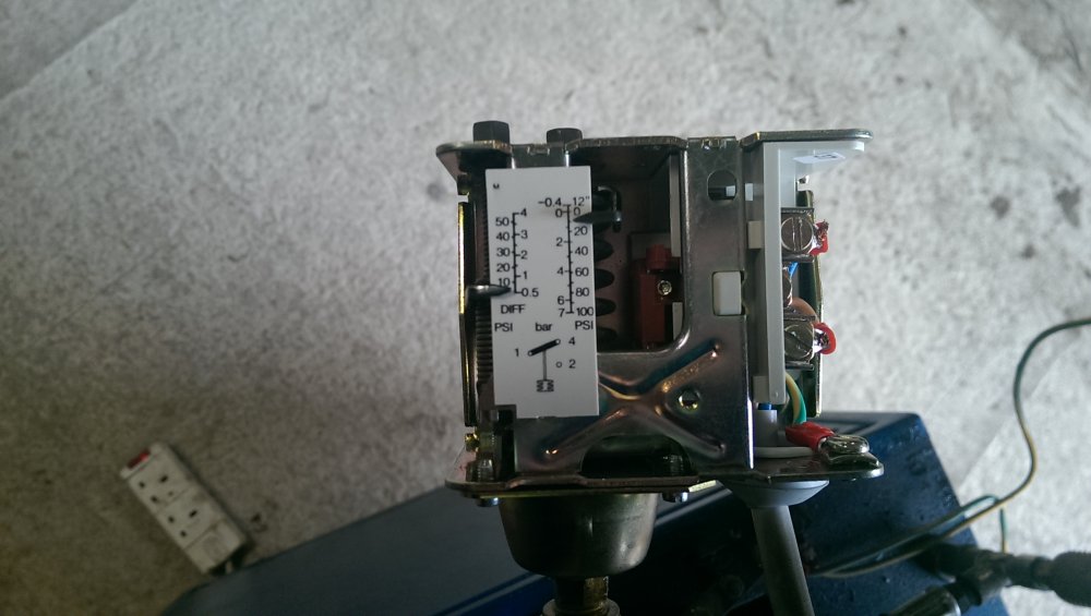

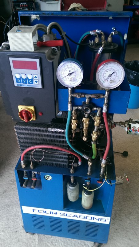

I picked this Air Con service station up cheap last year and was told that there was a problem with the vacuum pump. I have tested the pump and all works well, the problem seems to be the pressure switch fitted on the vacuum side - the sparse info I have says it is incorrectly calibrated or faulty.
Does anyone know how to:
1 Test these things
2 What the initial settings should be ( the lid was loose)
3 Where I can buy a replacement from, it appears the it is a Ranco 016-052 but I cant find where to buy one from.
. Thanks for the tip brightspark - id have never thought of that
. I managed to have a look at it last night when the heat from her who shall be obeyed had dissipated a bit and found that the pressure switch is connected to the back of the solenoid on the recovery line and is pressurised with gas. Setting the cut out to 4 bar works and the vacuum pump runs fine although I haven't got a clue what pressure to set the cut in to. I also haven't got a clue why it needs 4 bar pressure to operate a vacuum pump, more research needed I think. I might have to ask brightspark for another link
but in doing so I had to play about with the settings a bit. The instructions helped a lot when it stated that the recover function cuts out when the pressure drops below 0.8 bar and cuts back in at over 1.1 bar. It appears that the circuit has to be open vacuum pump to work which means that there is no more refrigerant to recover. It all makes sense now
