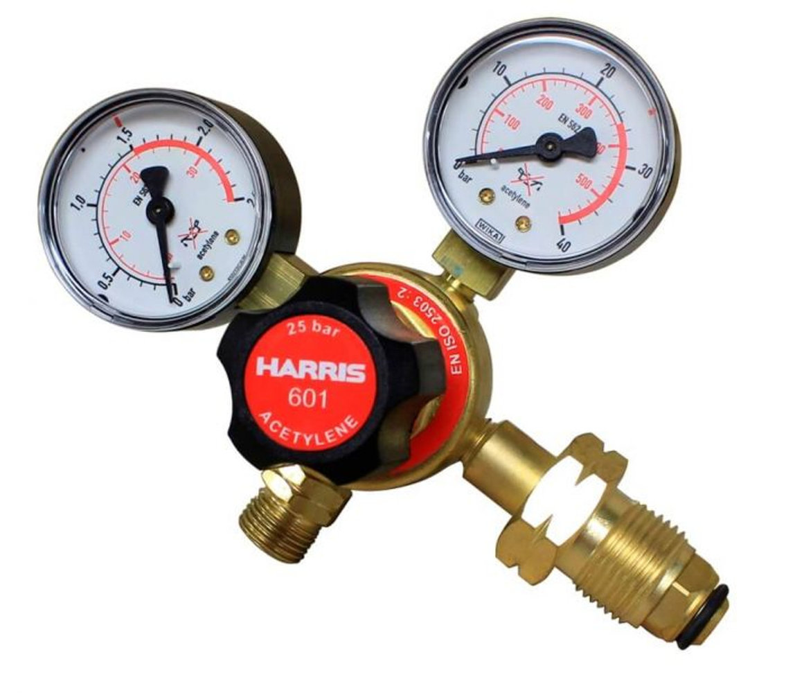

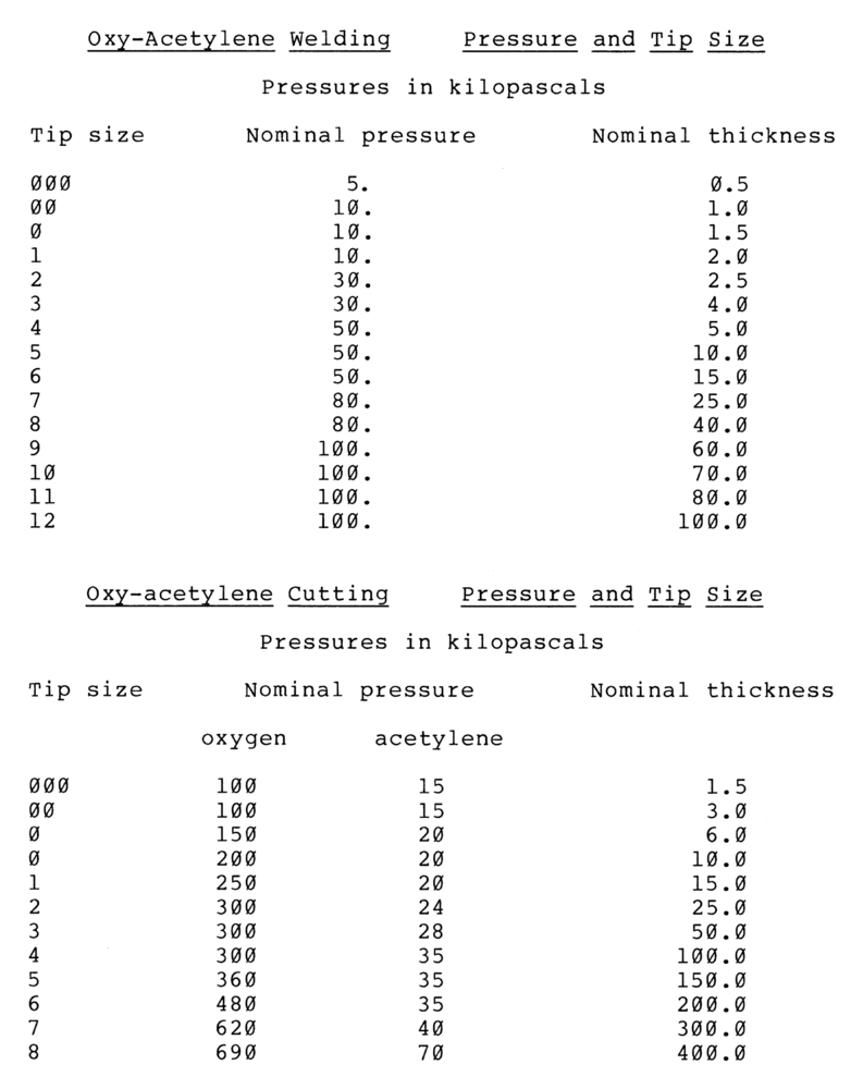

I'm starting out doing repairs on thin sheet metal (1mm) and getting conflicting info re pressure...
The table in my BOC welding guide suggests .14 BAR or 2 lbf/in2 for both with a number 2 nozzle
This doesn't seem to be hot enough to melt the rod into the weld-pool
Looking at online resources and YouTube videos they are suggesting about .3 BAR or 4 lbf/in2
I started out with this setting but the torch kept going out as soon as I tried to add the oxygen. I'm thinking it's perhaps too much pressure for such a small nozzle
The other thing I'm not sure about is can you let the flame melt the rod or does it have to be the weld-pool which does this?
