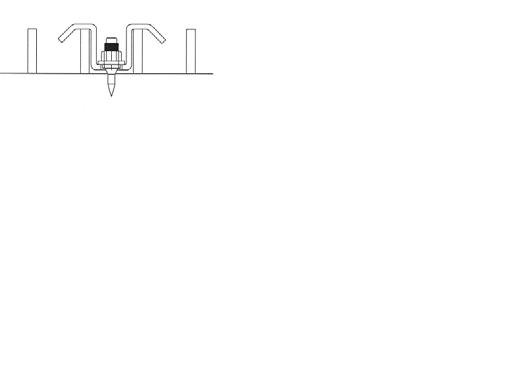

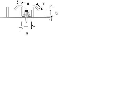

I'm trying to fathom a way of pressing these
We have 100-odd tonnes available to press em but i'm looking for ideas for the die and former. The bit im stuggling with is forming the two outer 'turn downs'. Anyone any bright ideas? There's loads to do, so ideally press in one operation. No nail hole required - just Hilti nail through the lot.
