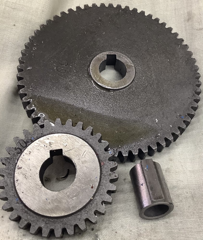

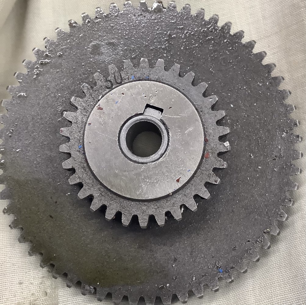

I have a few change gears for the lathe with too large a bore, I have some alu bar that I'm hoping will be fine to use, it's just round bar bought from Aalco so not sure exactly what grade it is
I've read .001" per inch of diameter is a good guide, does that seem reasonable for aluminium to cast iron, the plug/insert will need to be about 1.25 inch diameter
any problems with those materials/sizes?
