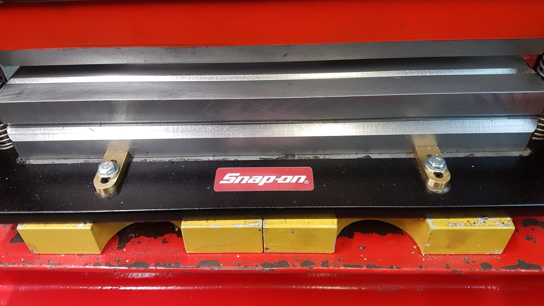

I like your styleignore the snapon stickers i put them on anything i make. mate is a snapon fan it realy winds him up. the bottom block has four different sized V's
I rather suspect that anything made by members in this forum would exceed SnapOn quality anyway.ignore the snapon stickers i put them on anything i make. mate is a snapon fan it realy winds him up. the bottom block has four different sized V's

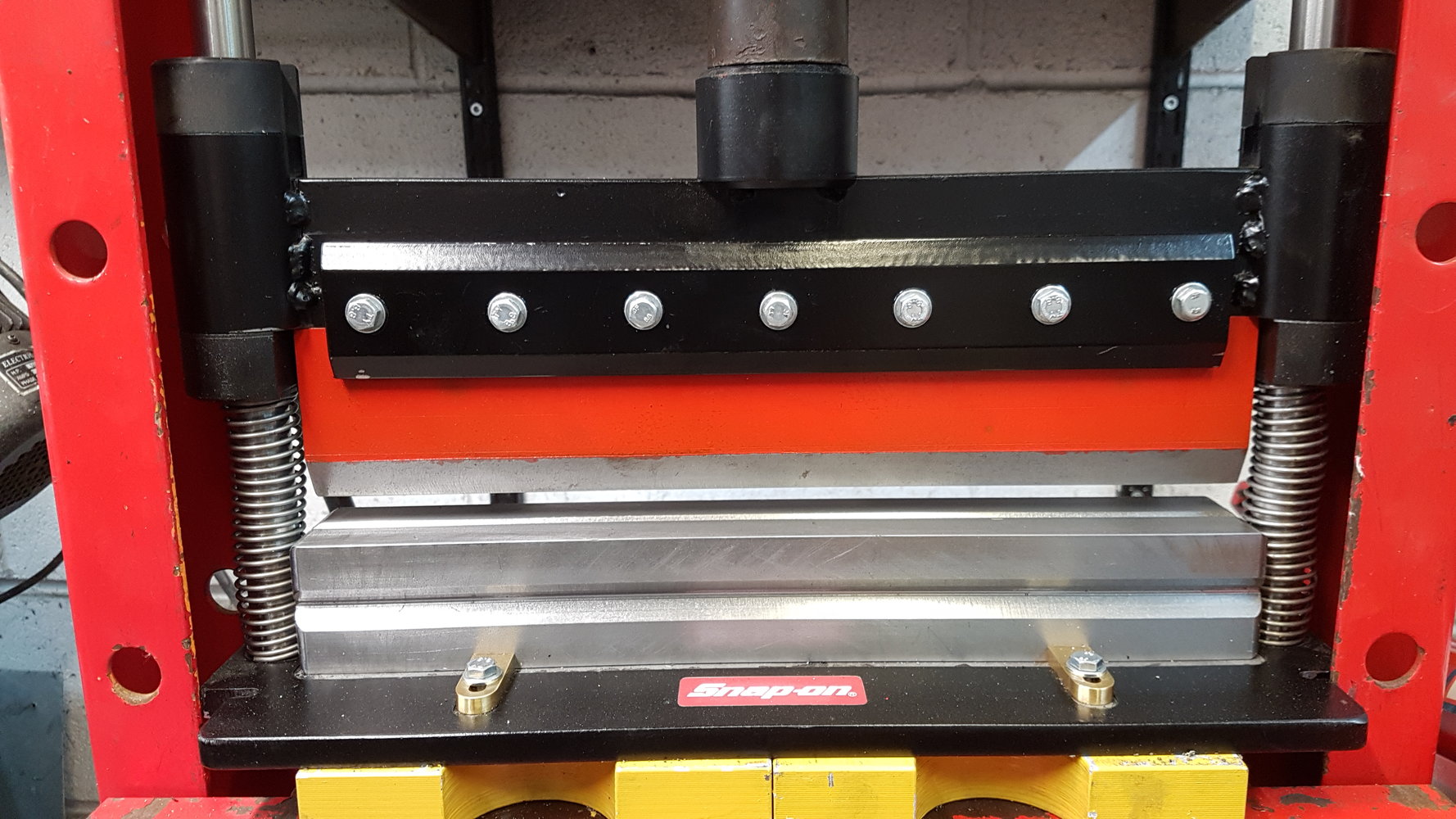

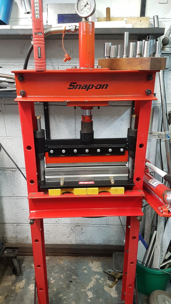

Do you mind me asking where did you get the 4 sided V block from?not posted for a while but i'm always here checking out what everyones doing. i needed to fold some thin brass with a tight radius so i made a folder to go into my press heres some picsView attachment 370476View attachment 370477View attachment 370478
Different size or different angle? If angles, what did you chose?ignore the snapon stickers i put them on anything i make. mate is a snapon fan it realy winds him up. the bottom block has four different sized V's
Gotcha and makes complete sense nowbrightspark got it right. milling machine and a 50mm square chunk. the V's are different sizes for different thickness material to be bent. your V should be eight times the thinkness IE 0ne mm thick plate and your V should be eight mm at the widest point. this is only a general rule it all depends how tight you want the radius of the fold. i have a smaller v as i needed a realy tight radius.
