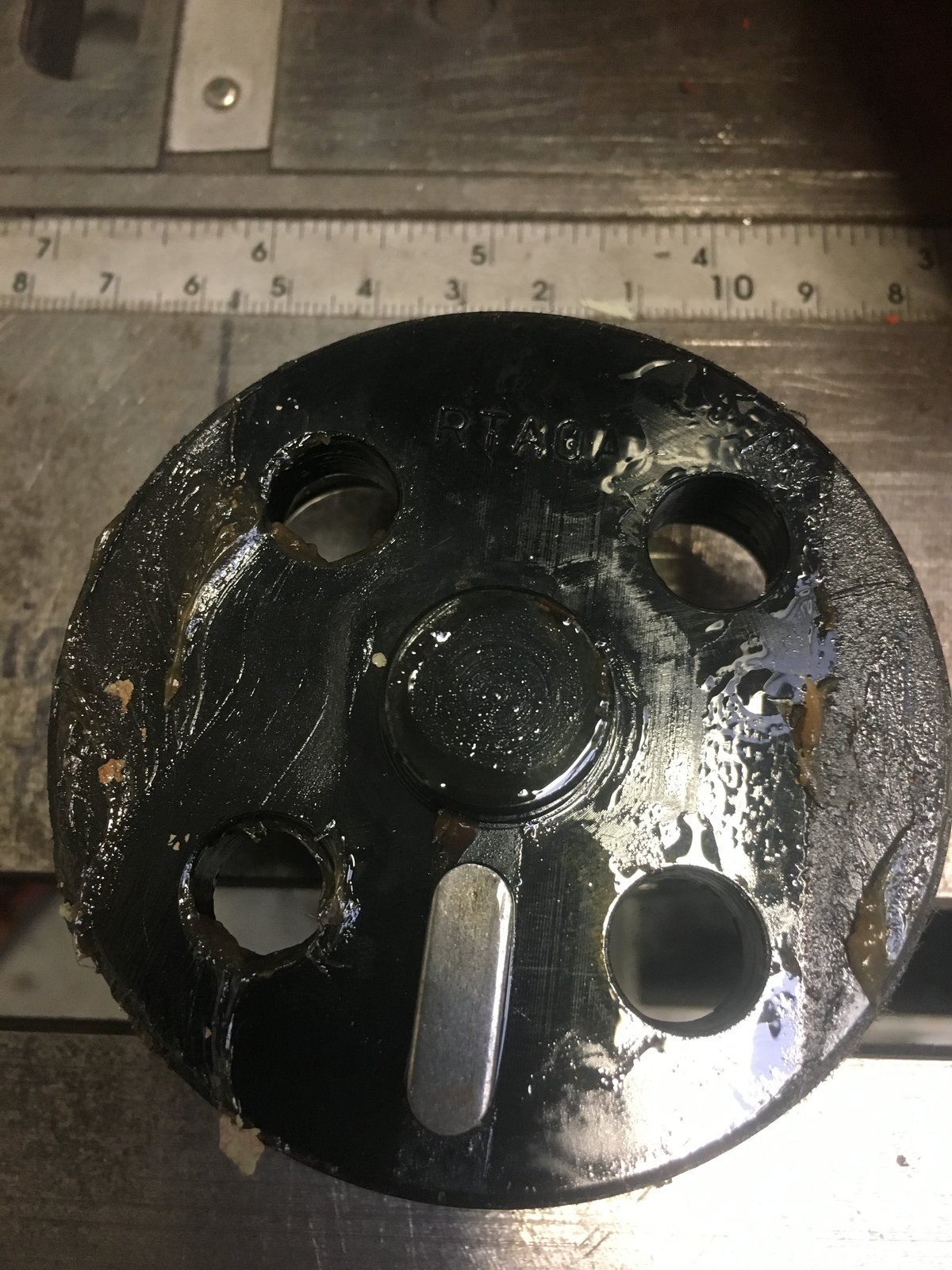

Which currently a punch holder screws onto on the underside. My thinking is to get a round machined to same as this with the four bolt holes,centre peg and keyway. The other side I can get machined to accept a holder for the tooling

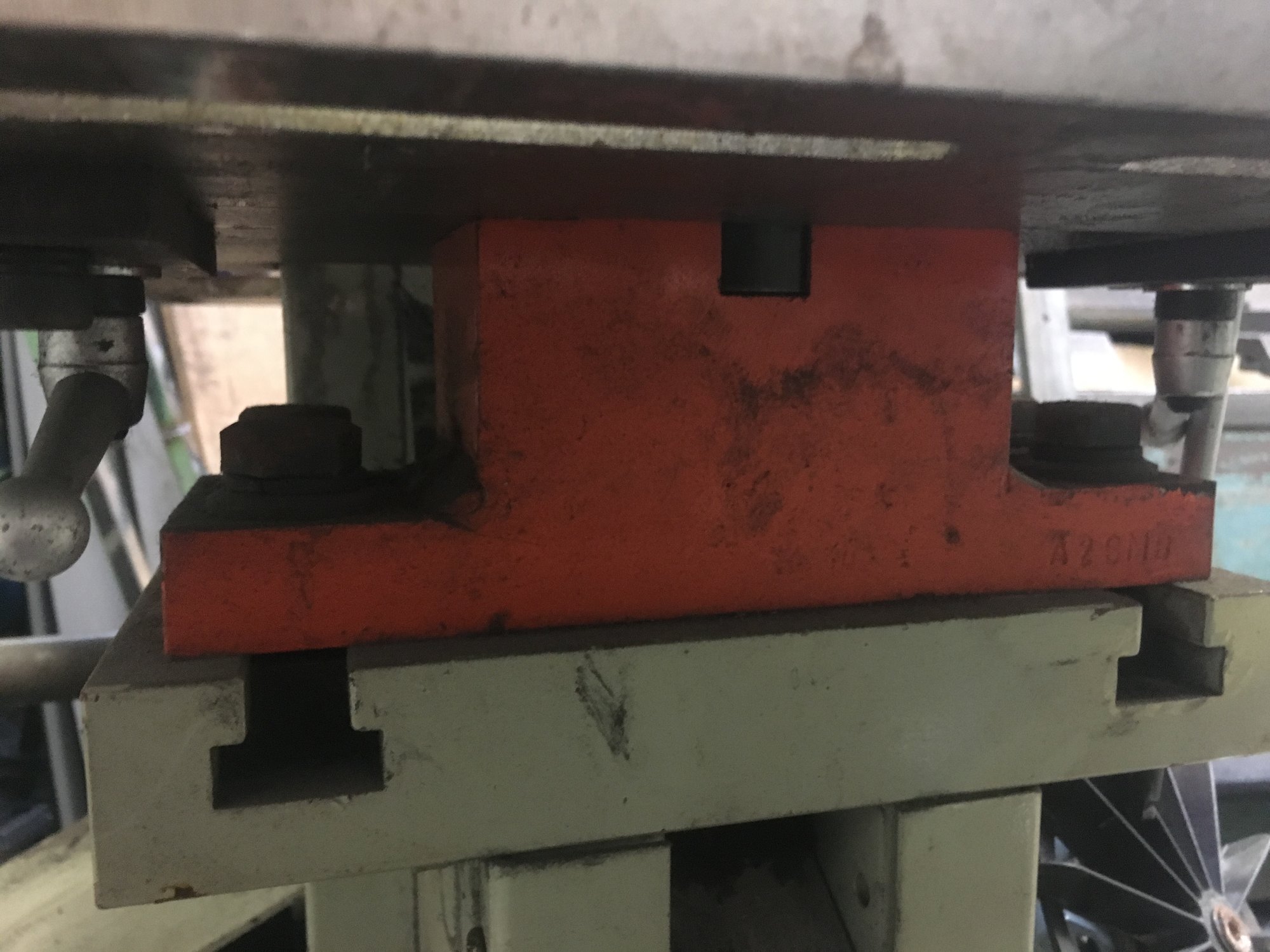

The bottom is on t slots
Which I can use a flat plate and then a tooling holder bolted on.
Top and bottom tooling holders I could either buy if reasonable price or they appear to be a simple machined block?
