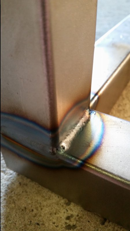

I did a spot of reading here, and watched the tutorials and decided to have a bash. Now, there are a few small flaws in my setup. I don't own a bench grinder (yet) so I am using a 120 grit flap disc on a 4 1/2" grinder to sharpen my tungstens (something that I found myself doing rather frequently at first!) And my bench height/seating setup isn't ideal.. but apart from that I think I have the bases covered.
I have had maybe 3 or 4 sessions at it now and seem to be progressing, but I would like some criticism/feedback to make sure I'm getting things right. Below are a couple of welds on 1.5mm 40x40 mild steel box, done with a 1.6mm tungsten at approx 40 amps.
I know my beads aren't very stright/neat and I hope a steadier hand will come with practice but is there anything glaringly wrong with them? Is the first undefiled a bit? And should the heat discolouration have spread so far on the second? I will admit the second weld did involve a touch of weaving... but I have since read that this needs knocked on the head! Oops...

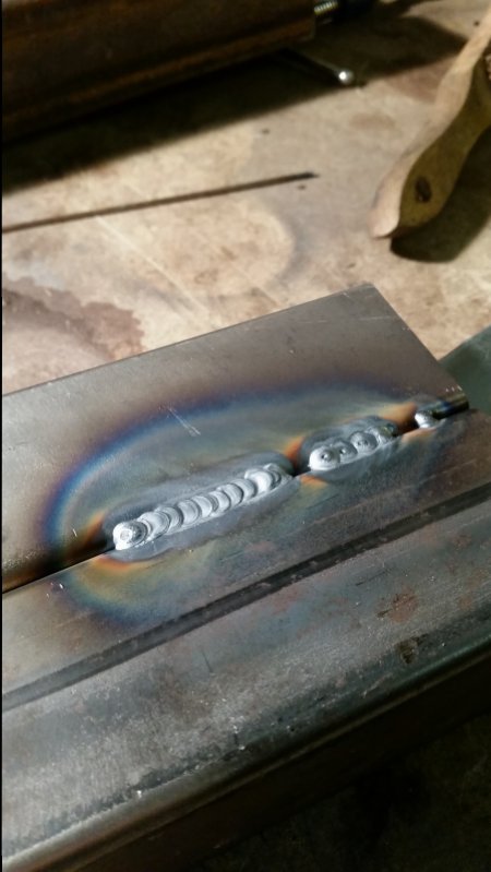

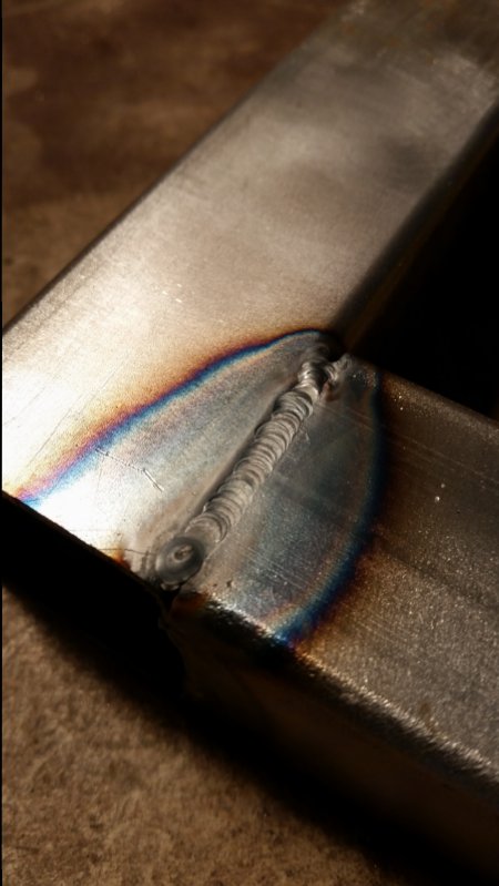

I went out for another play this evening with some much heavier material and produced these with a 2.4 mm tungsten at nearly 100 amps.
The weld on the right was several individual spots as I was just getting used to how the heavier material melted, then the weld on the left was done in one go. There was full penetration through the box but I am wondering if it would be normal to try and create such a heavy TIG weld in one pass? It did take a lot of filler and holding the torch in the same spot for a while?
