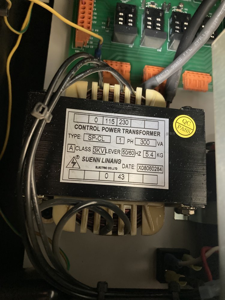

Hi all got a promecam Pressbrake with Hurco autobend 7 cnc control unit. Keeps powering off completely eventually I can get it to switch on again only for it to switch off again
I’ve spoken with an engineer that I know and they suggested the control transformer is probably faulty.
I’ve opened the cabinet and sure enough it’s red hot to touch so that’s potentially the cause so was going to swap for a new one and hope that solves it if not I’ll have to call an engineer in to look at it
Just wondered if anyone can suggest a direct replacement for it I’d prefer a good quality unit as this is used quite a lot.
