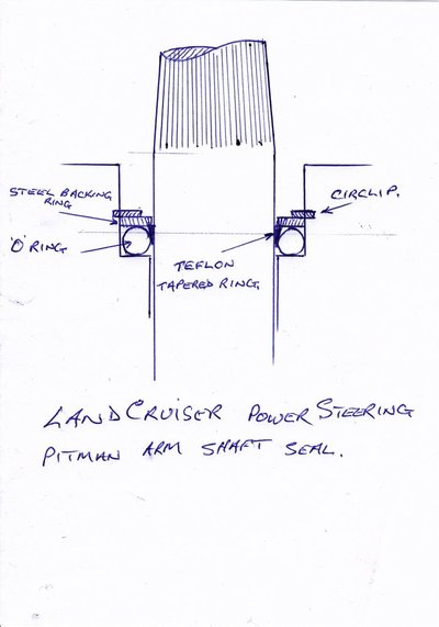

Hope somebody can help with a little info,
My Land cruiser started leaking(a lot) from the sector shaft that carries the Pitman arm,Very simple arrangement of just an "O" ring and a thin tapered teflon ring held in with a backing ring and circlip.I have searched the net and been to half a dozen seal/hydraulic repairers and completely drawn a blank.I may have to just but a new nitrile/viton "o" ring and turn the teflon tapered ring.Would be grateful if anybody has come across this type of seal,Just to know what sort of pre-load if any that is needed on top of the teflon to seat it between the shaft and "o" ring,amazingly simple seal that holds quite a lot of pressure,(in excess of 500psi i believe)
Thanks in advance, Gordon.
