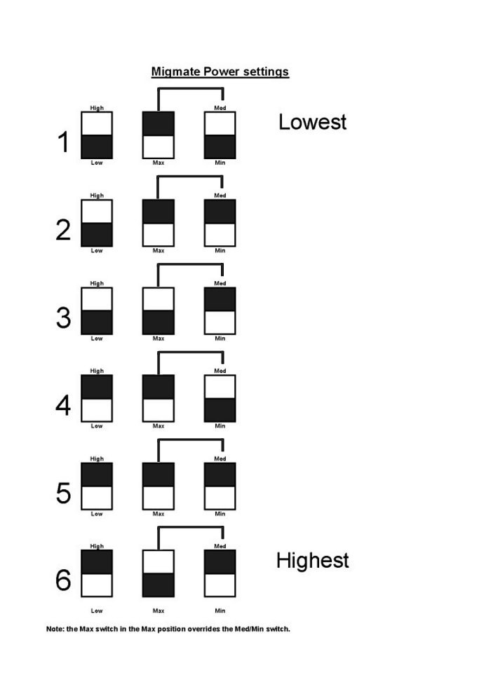

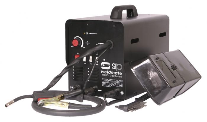

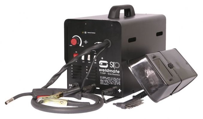

I've recently brought a sip migmate 150 welder.
I am not used to the switch type, for the power settings. I've used the industrial mig welders, with the
course lever for power & fine lever for fine adjustment, which is shown as course as large steps & fine as smaller steps for minor adjustment. could you tell me which switch is the course one for major move up as it is really not explained clearly in the manual...Dean
