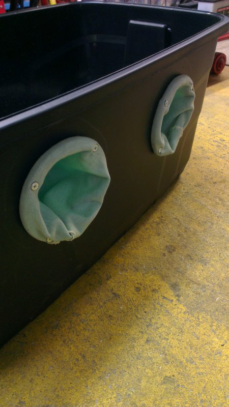

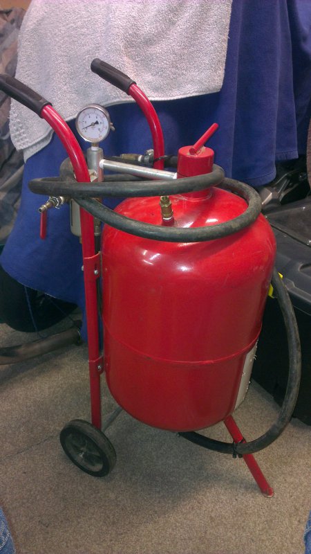

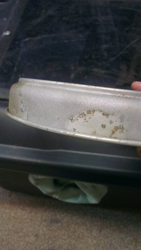

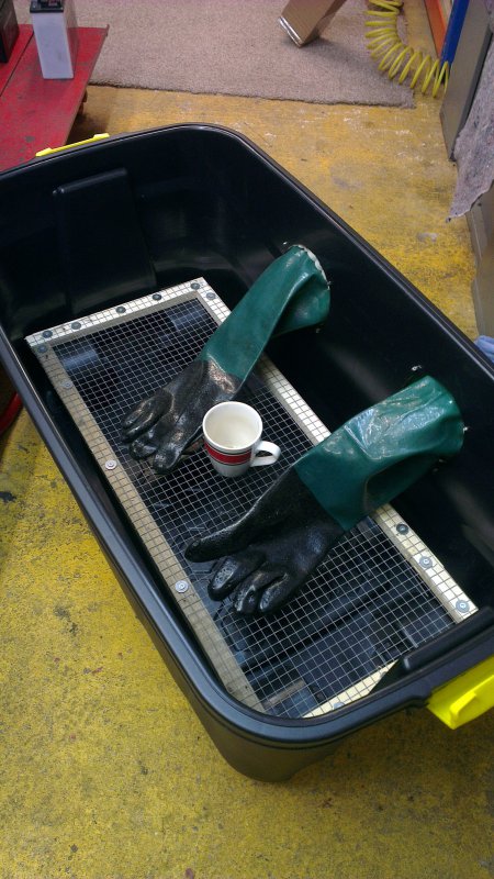

I've been making a blasting cabinet ready for some bike parts I wanted to clean up,
Here's a few pics of what I've done.
It's just a storage box from B&Q with some perspex fitted in the lid.
A pair of eBay rubber gloves fixed with a couple of plywood rings.
I still need to make a rubber gasket for the lid and an entry for the hose but it works pretty well with my bargain blasting pot I got off eBay for £25!
This took about 10 seconds to do.
Blast media everywhere thought.....
The pot needed a bit of fettling with an O ring and some ptfe tape to stop the leaks but it all seems to work quite well.
Any advice on what is the best media for general part cleaning and then for when I do the engine,
I was thinking soda for the engine so I won't damage anything IF a bit gets inside it.
Cheers.
