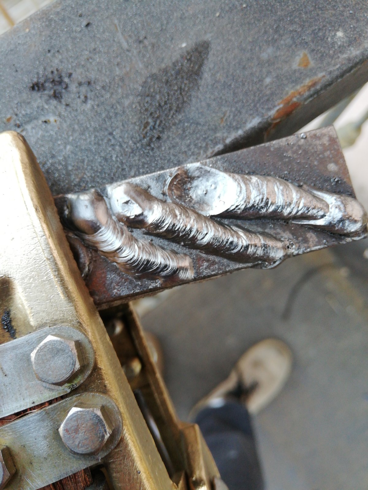

Yesterday I was welding something with my cheapo inverter
Was repairing a clam fishing rake to be short we'll call this thing CFD if we need to repeat
So essentially I had my welder set at around 85/90A I was welding a new thoot on the CFD
Material thickness was 8mm (rebar thoot) to 4mm
Instead of welding I've practically cut through using 2.5mm 6013 ,the rebar became water (C34)
I thought that might be just because the thoot was small so it will heat quickly so dial down to around 70A still to hot,50A to hot ,40A was good enough and the welder was working very well .
Two things to consider
the CFD being used in salt water is very very rusted out ,but the rebar wasn't.
With 40A I being able to open root
I thought various causes to that expecially a potentiometer failure but before to open up the welder I would like get advice about.
-I've recently cleaned up my ground clamp an electrode holder (shiny brass seems gold)
May this affect welding ?
-being the CFD heavily corroded might be part of the causes of blowing through 4mm thick flat bar?
(Ps rusty but not corn flakes looking rust)
-maybe my fault ?
Wrong rod angles?
what I thought is a potentiometer failure but before to open desolder and check would like to know what you think about
Thanks in advance
