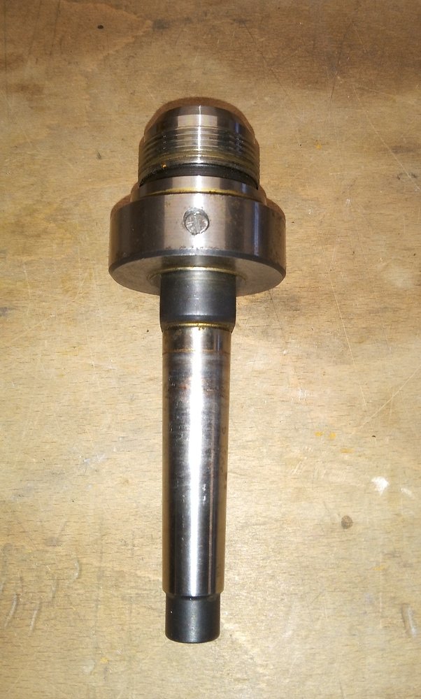

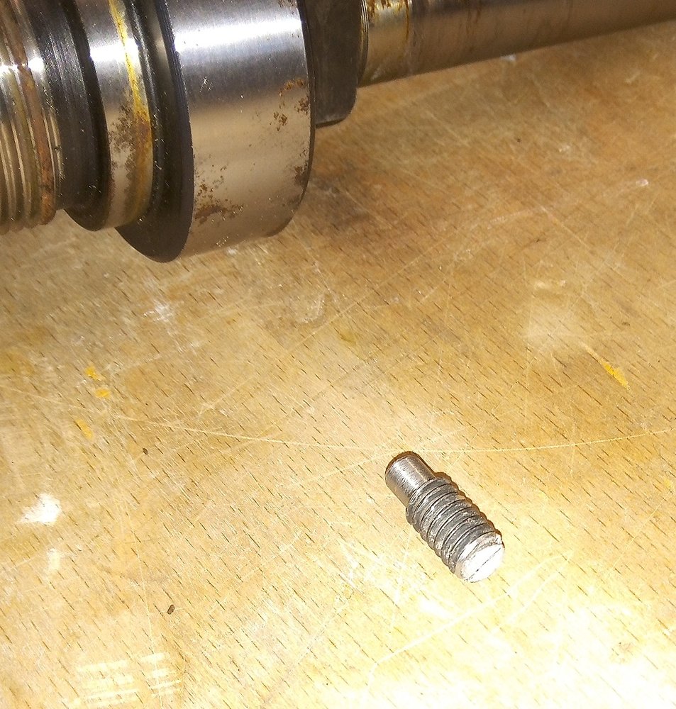

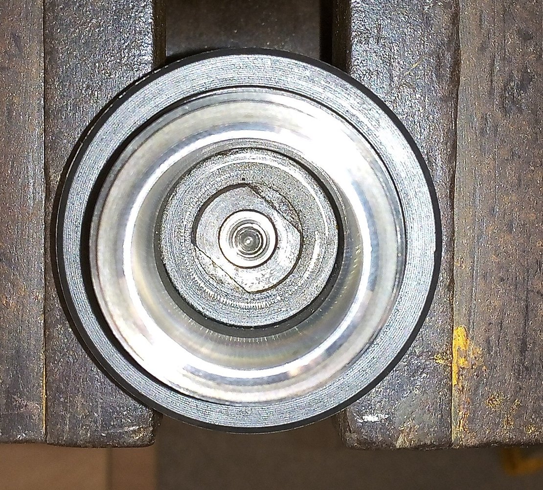

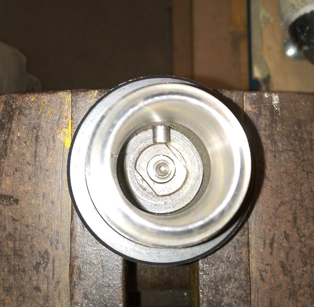

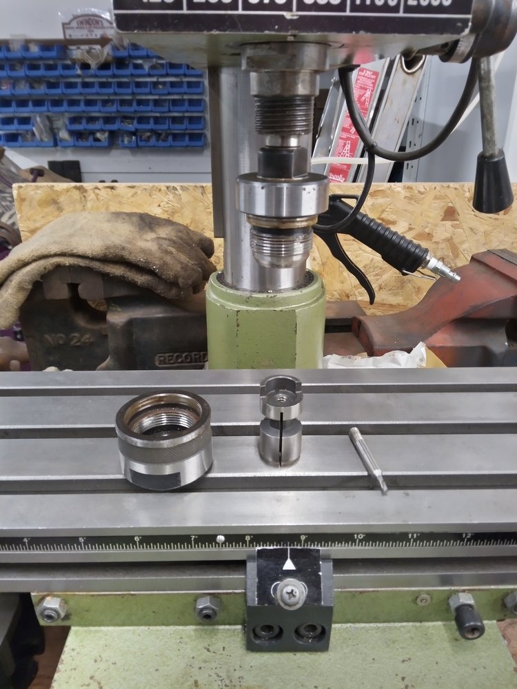

I thought I'd have a little play with it the other day, under the guidance of another pal who is a very experienced and accomplished 'miller' only to discover that there now seems to be something missing from the inside of the chuck. When I put a collet into the chuck and tightened it up, it neither locked into the top of the chuck (preventing rotation) nor did it even become tight when the chuck is fully done up.
I suspect that whatever is missing has dropped out whilst the milling machine has been sat like this for the last few months:
Absolutely n zero chance of it being lying around anywhere, I sweep up far too often for that. Let that be a lesson to me!
What I'm hoping,is that someone out there has the same posilock set up that I have and can perhaps let me see what it is that I'm missing in the vain hope I can make one rather than have to spend £££ on a replacement chuck.

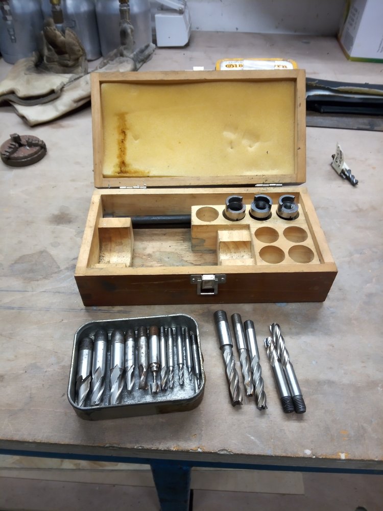

Last week, I took a further delivery of various stuff from the same source and in amongst it all was this box:
Great news! I now have 3 more collets and some mills!
However!
TIA
Richard.
