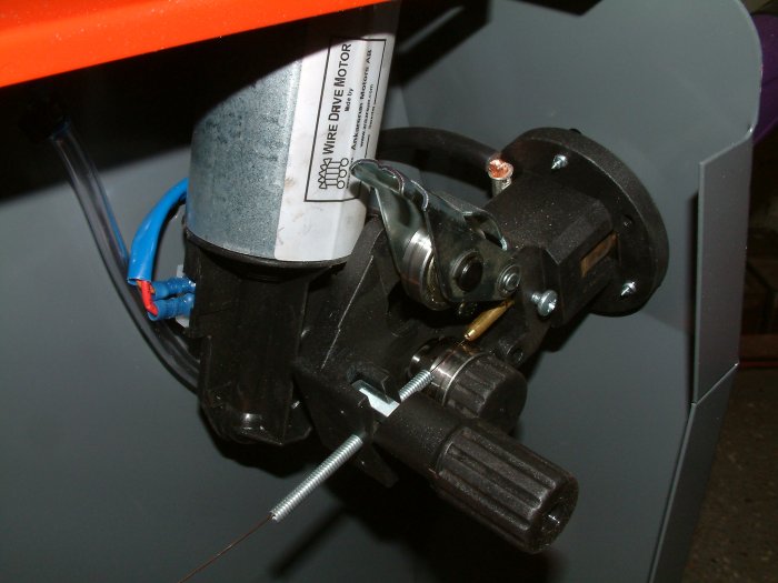

Swaping the wire to 0.6mm was a doddle as the wire feed unit has a quick release roller tensioner that stays set and the sprung loaded top roller arm flips neatly out of the way for access. The feed roller is held on with a thumb screw too so no tools are needed to change the wire size. These are two really nice features as my old Einhell SGA 175 Turbo has a wirefeed unit like the Sealey/Telwin machines that needs a thumbscrew removing to release the top roller and a screwdriver to change the wire size. Once changed you then have to reset the roller tension.

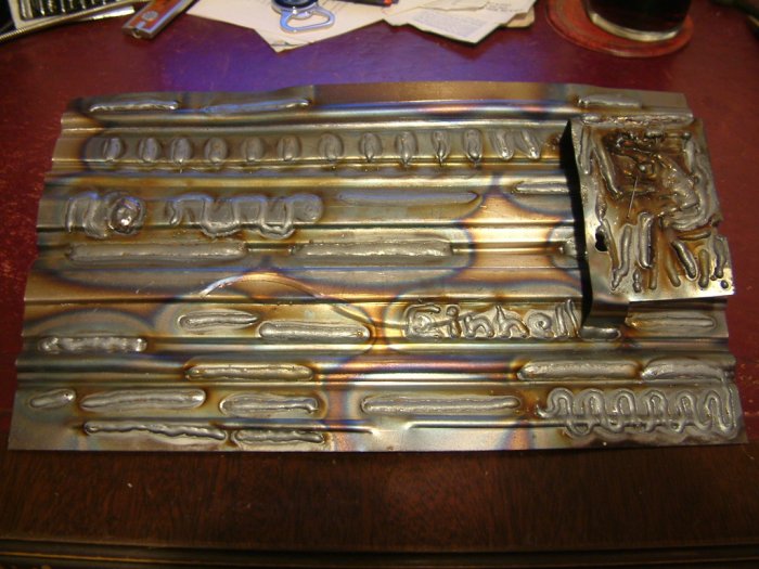

I decided a direct comparison would be in order with my old machine on the lowest setting laying a few beads next to eachother so with a Y piece on the bottle I set the machines up side by side and ran some beads on 0.8mm sheet.
The Einhell works well and always has from day one, it's like a comfy old pair of shoes, I just pick the torch up and go hence I got a bit carried away playing with it before letting it go.
In comparison to the Portamig on 0.8mm sheet you need to work faster with the Einhell, no two ways about it, hang around you blow through the sheet. The Portamig is definitely more controllable on 0.8mm sheet due to the lower voltage and gave me confidence in the machine straight away so it looks like I made the right decision to trade up.
Nice quick release, quick change features on the wirefeed

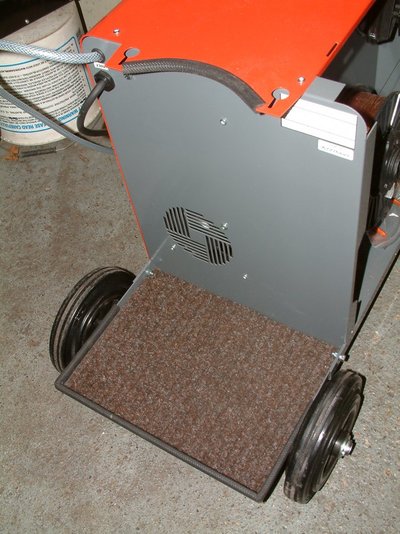

Added PVC edge trim to protect the paint from the gas bottle and temporary carpet until I can get rubber sheet!

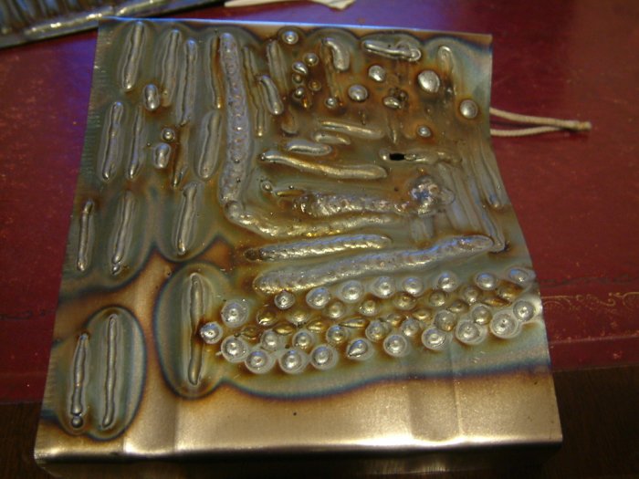

2mm sheet with a mix of beads from both machines
0.8mm sheet with beads mainly from the old Einhell

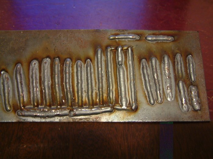

0.8mm sheet, straight beads on the left from the Portamig and messing about with the spotweld timer on the Einhell.

I decided a direct comparison would be in order with my old machine on the lowest setting laying a few beads next to eachother so with a Y piece on the bottle I set the machines up side by side and ran some beads on 0.8mm sheet.The Einhell works well and always has from day one, it's like a comfy old pair of shoes, I just pick the torch up and go hence I got a bit carried away playing with it before letting it go.

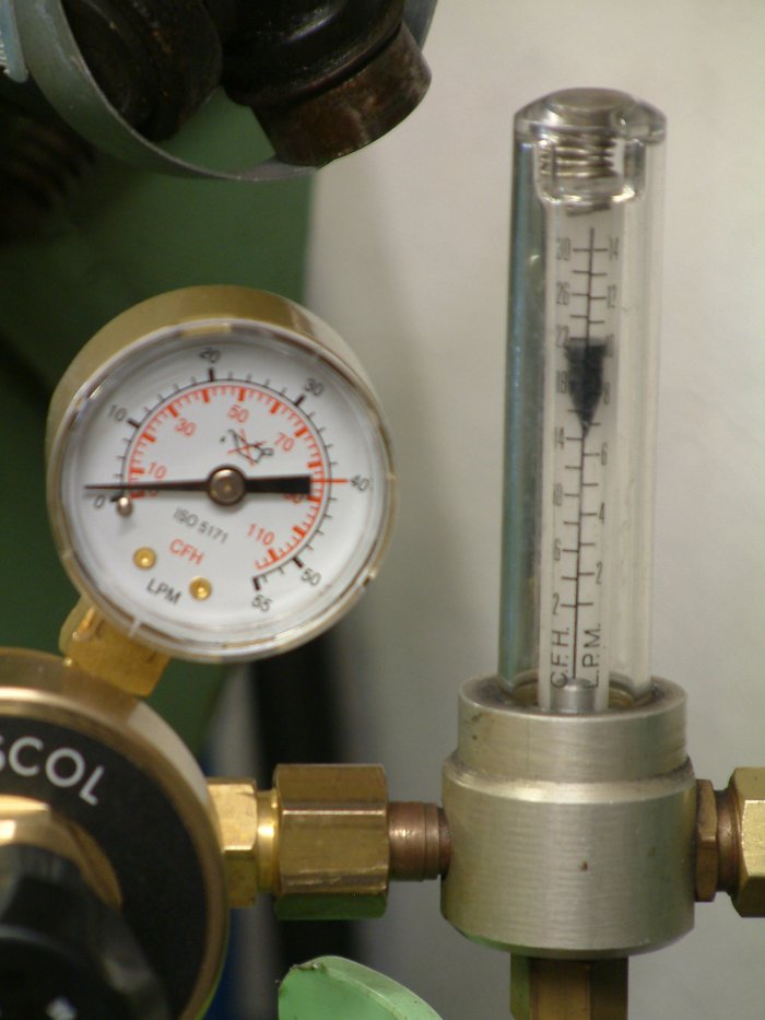

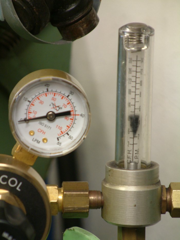

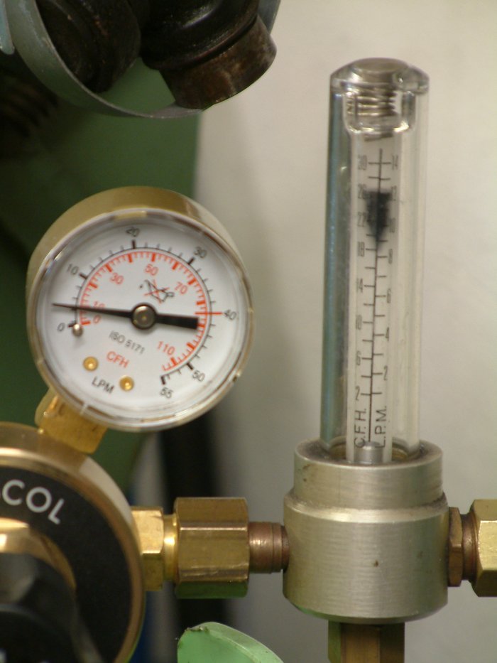

Here are a couple of slightly out of focus photos showing the flow readings in comparison to the pressure gauge, all readings are done with the flowmeter resrictor open and the flow set by the regulator:
