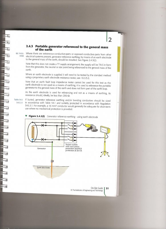

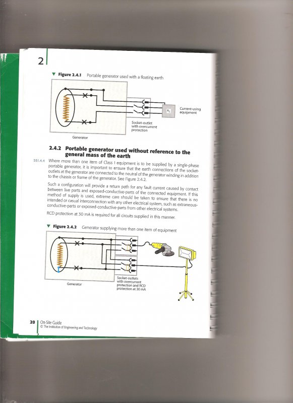

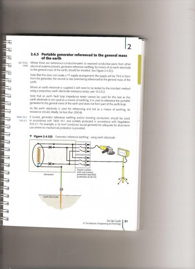

I do a lot of generator work on sites and the big ones all need an earth electrode.
Anything portable under 10 kva doesn't.
If it's small and feeding portable tools you don't need an electrode either ( it wouldn't be portable otherwise!)
