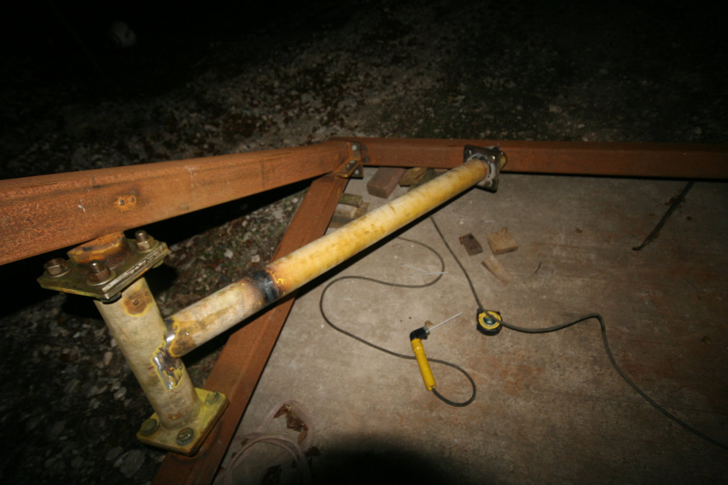

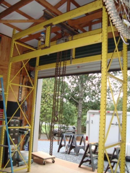

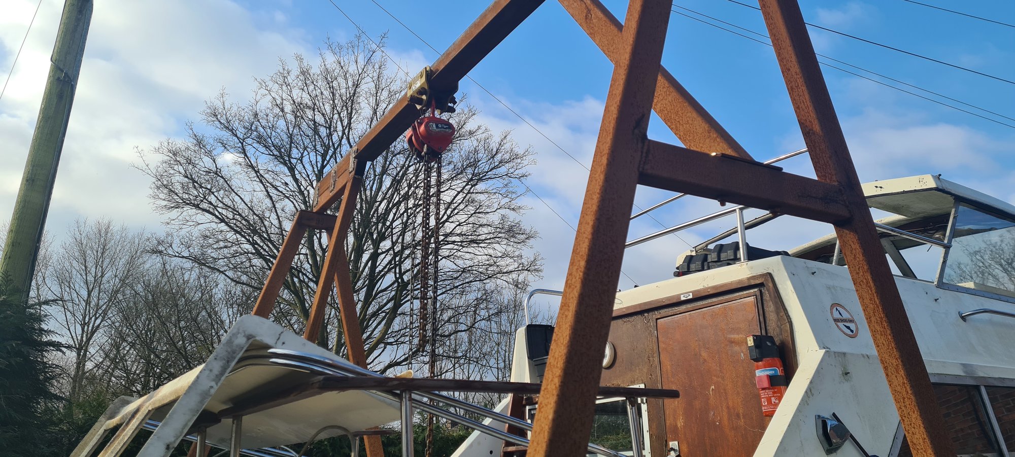

Also as I couldn’t get the lathe outside the A frame is too high by about 2 foot.

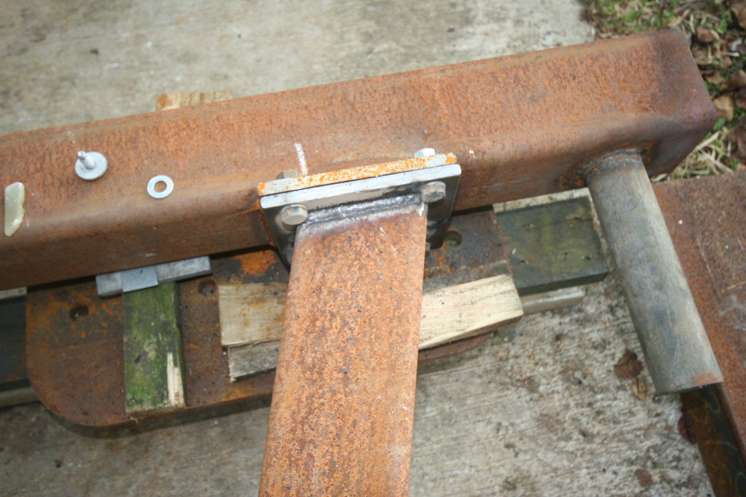

The sellers better half suggested the obvious solution of making it two foot shorter and as they had a plasma and a welder this is what we did.

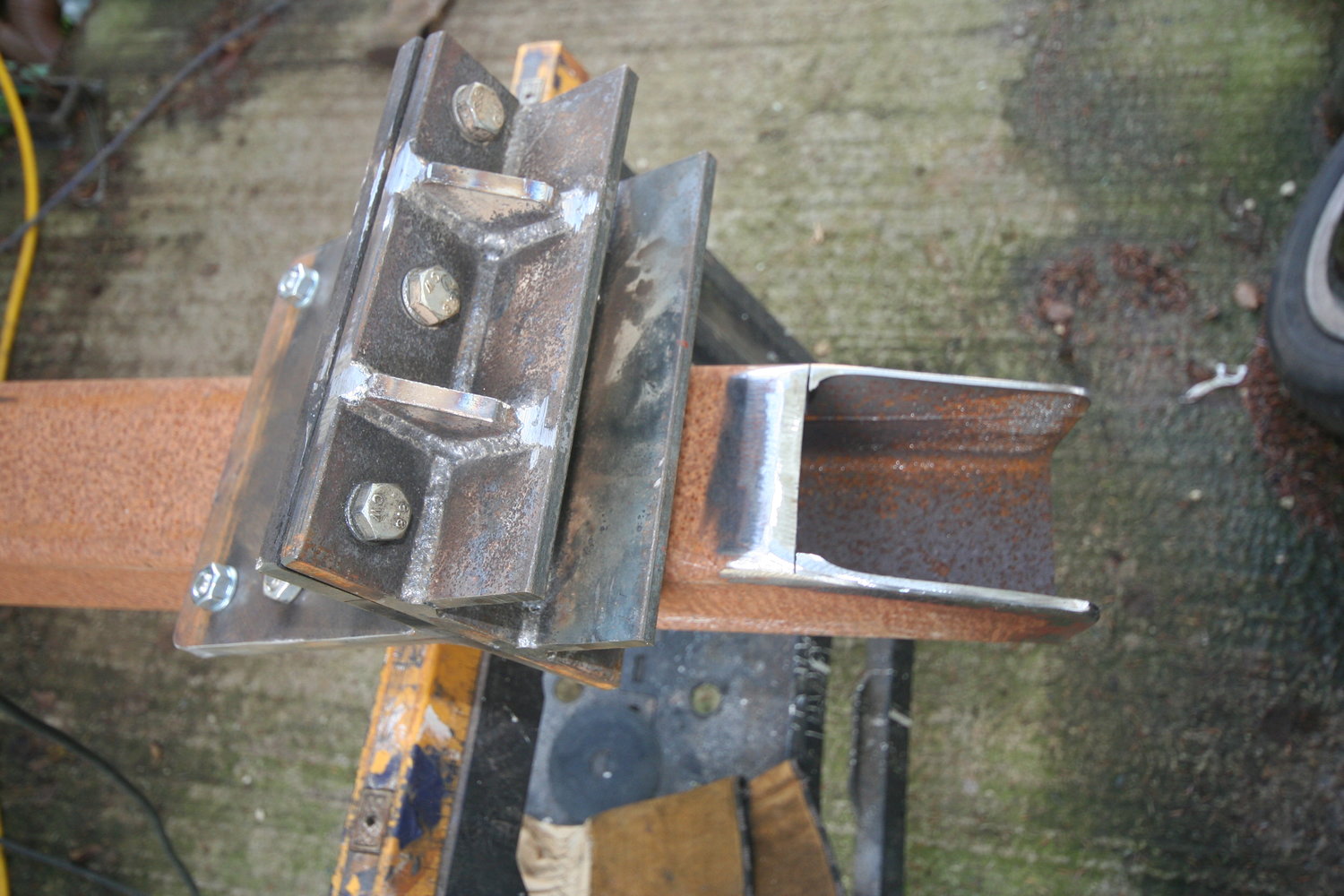

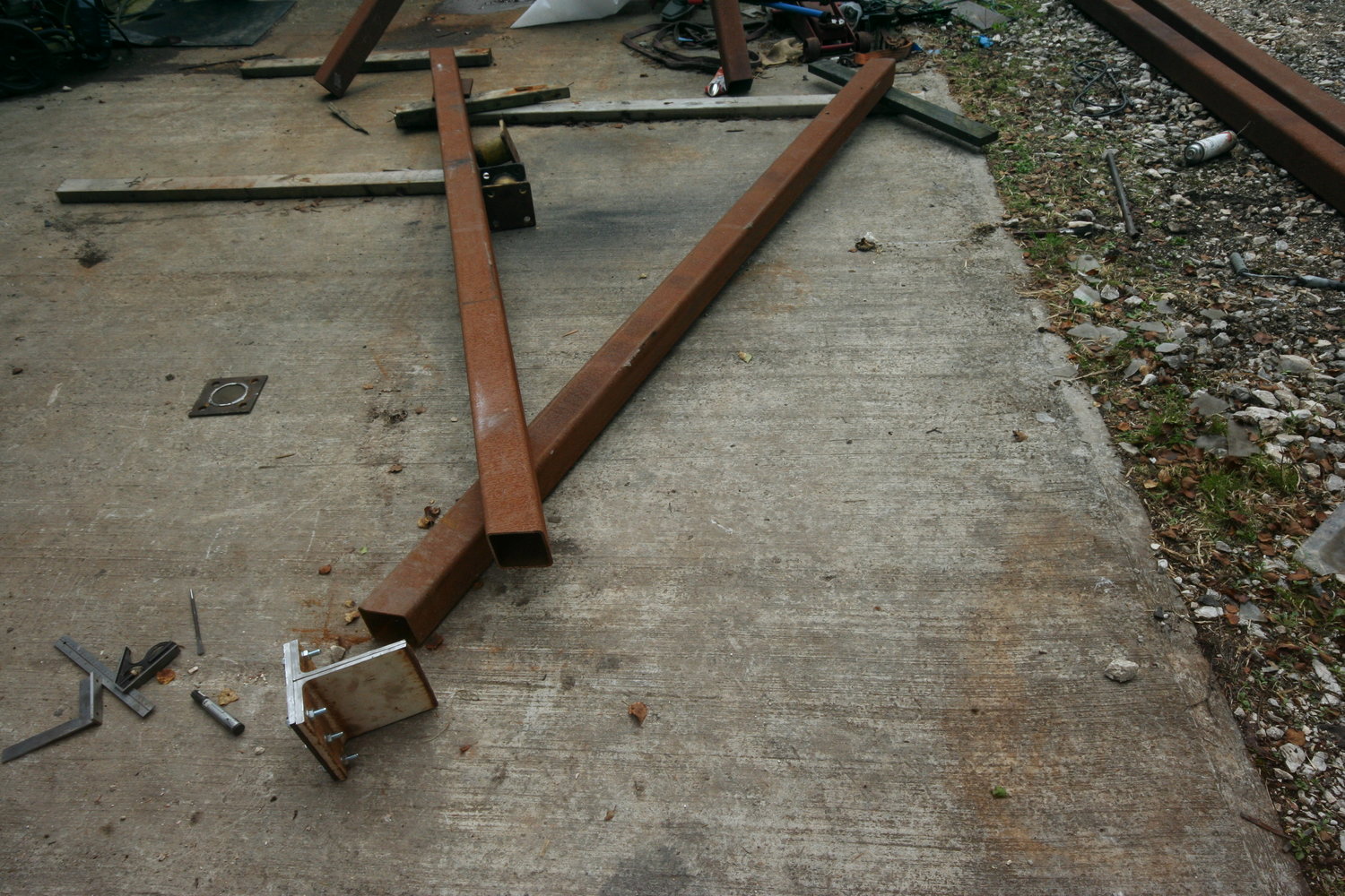

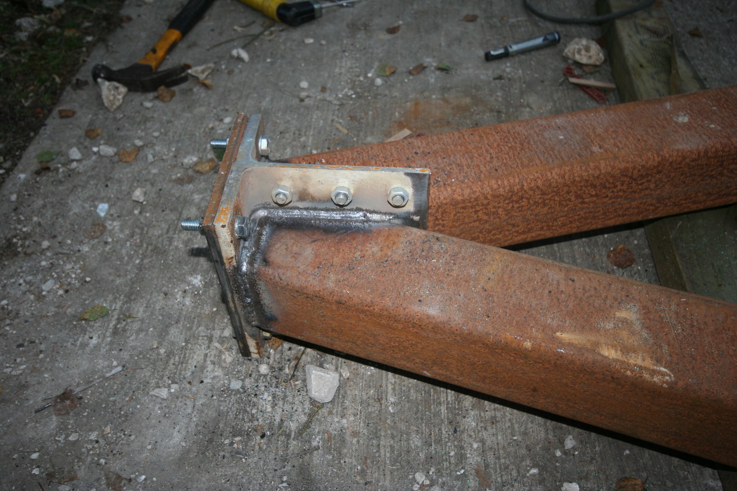

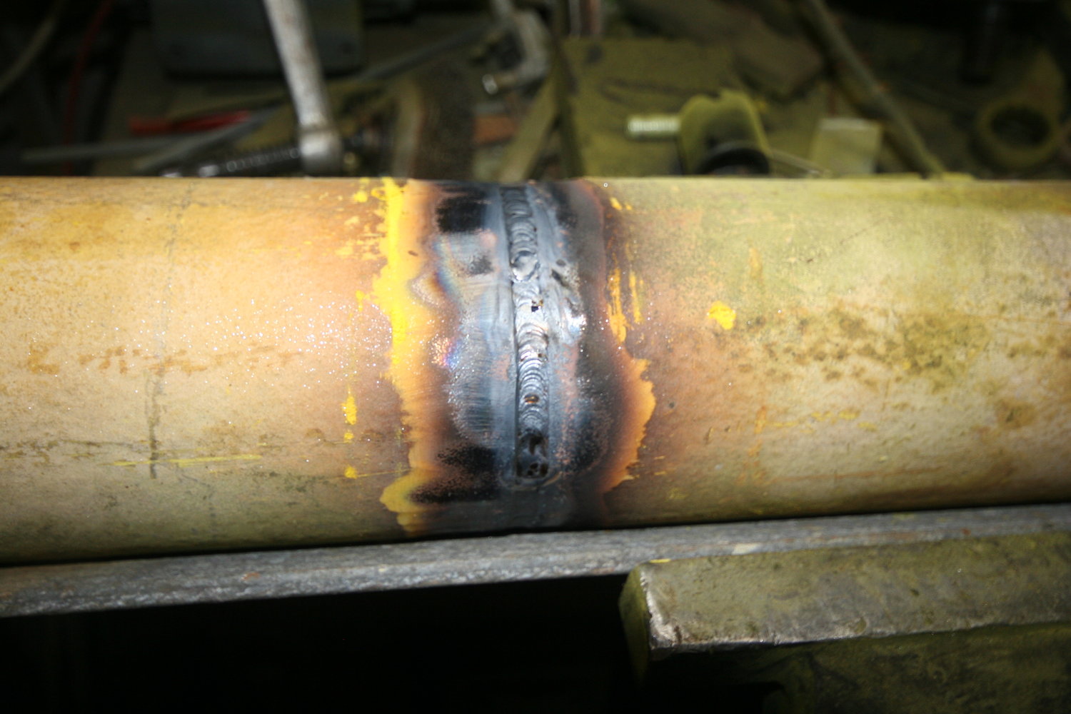

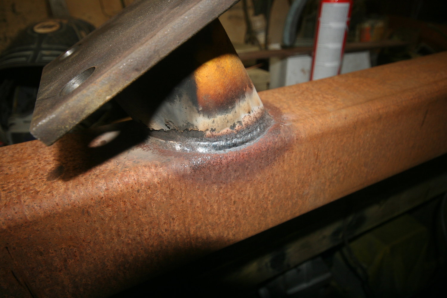

I welded the uprights close to one end to make it easier to erect from the beam end (as in the photo above) and not erect each frame from laying on the flat then put on the cross beam, which was my original intention. I'm going to keep this setup when I properly mod it for working inside my garage as it will also get me closer to walls.

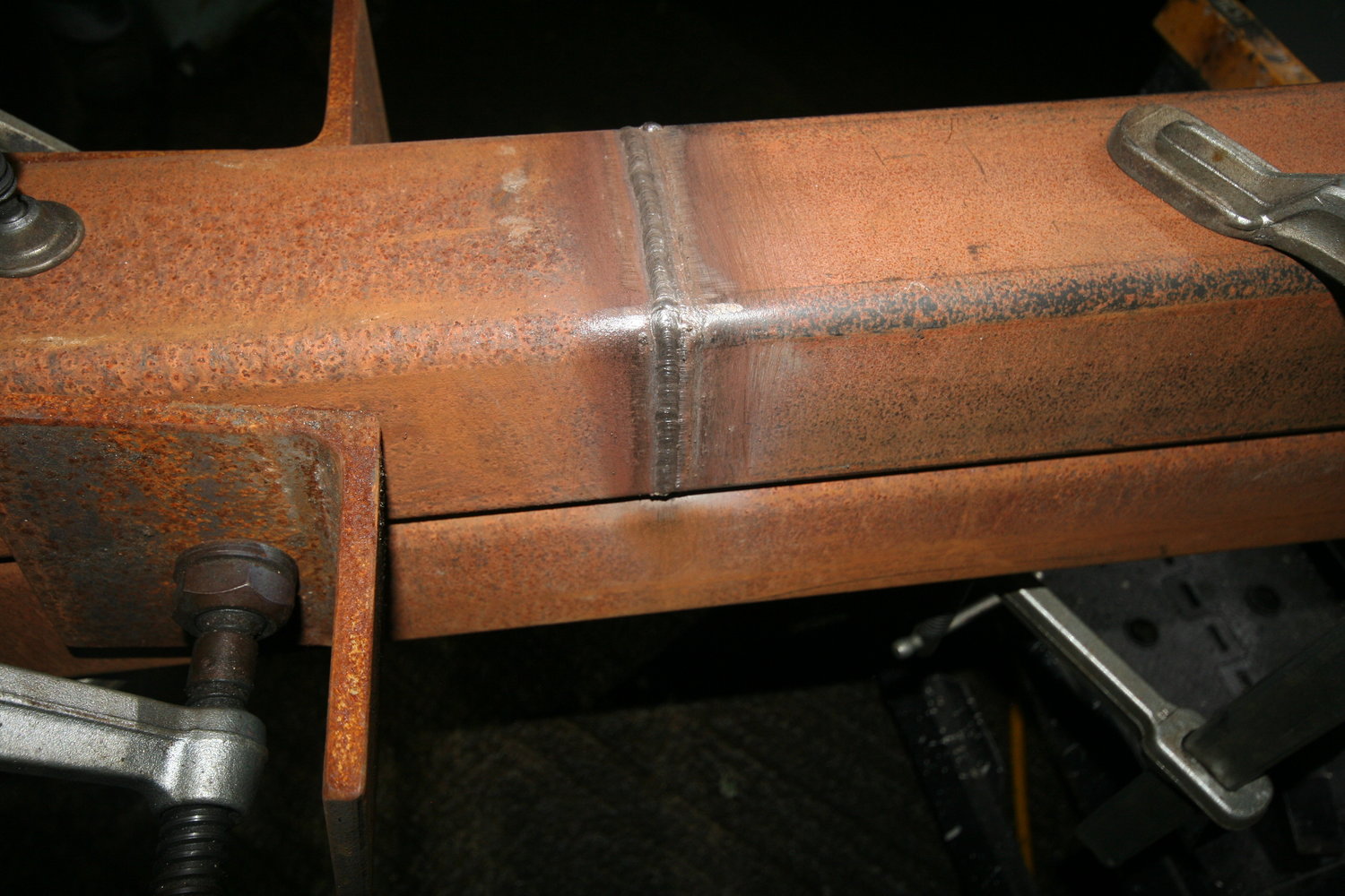

You might also notice that I didn’t put the props in before I welded the uprights to the base and they ended up being too tight to go in. I will really be giving the cross beam (and my welding) a proper workout. The sums say it's ok as long as the lathe weighs what it should. (and I didn't balls up the welding)

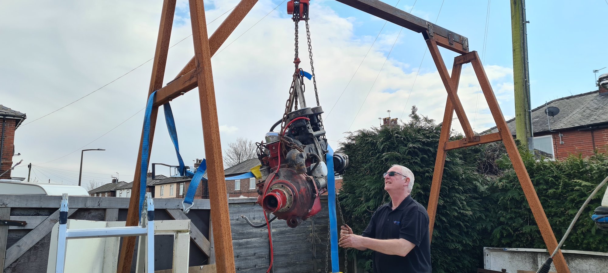

Bolted the cross beam to the uprights on the ground then lifted the whole thing vertical. Good job there was plenty of help, (I did bring a winch for the job) however man and women power was quicker.
Once up, we packed under the base with timber and the offcuts of the uprights to get as much height between the shed rafters as possible.
The block and tackle I brought was 2t SWL and not really up to the job, so I brought a sheeve block to double the capacity.
However with the reduced head height I couldn’t rig the sheeve block so I gave it a go with just the block and tackle. We did take a few bits off - chuck, tailstock, tool holder, to reduce some weight.
Lifting point was as the manual with an 1 3/4 inch bar through the hole provided and a line to steady the tailstock end. With the chuck and tailstock off I was able to adjust the position of the saddle to get it to lift perfectly on the single main lifting point and didnt bother with the steady line.
Even at that, we needed to shorten the rigging as much as possible and it ended up clashing with the head stock spindle so I packed it with timber to protect the bearings.
All went well, the cross beam hardly budged and after letting some air out of the tyres we got the trailer under the lathe and lowered down.
The wee block and tackle was under serious pressure but I can confirm an unloved Yale 2t block will lift over 2 tons.

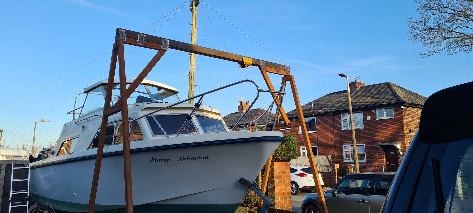

All said the A frame worked well and I don't see how I would have got the lathe loaded without it.
Awesome and that lathe is stunning!
Glad the gantry worked well for you.
