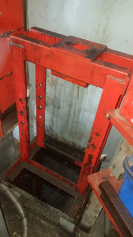

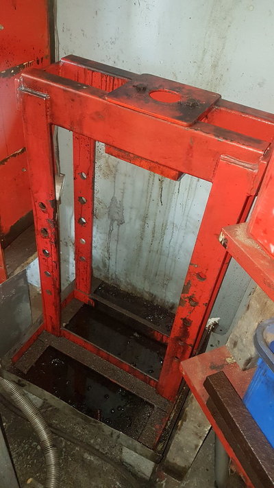

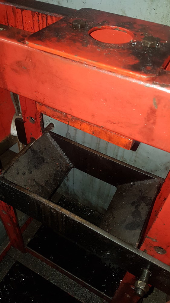

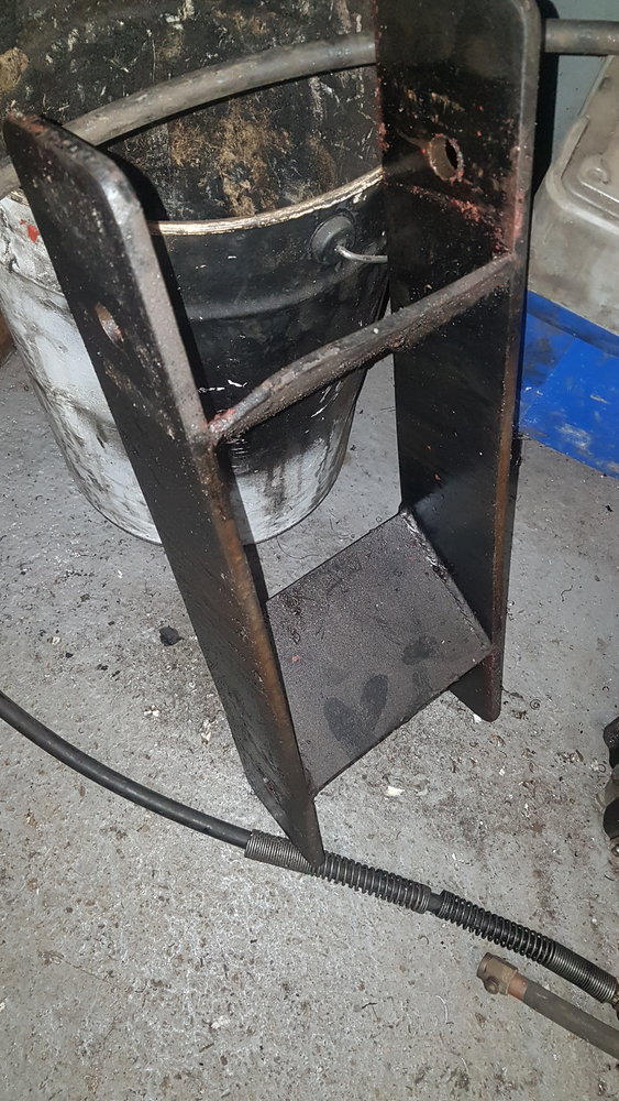

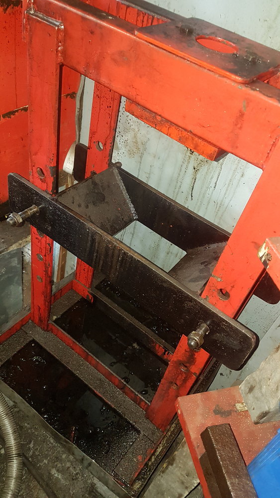

2 uprights of 6"x 3" x 3/8" U channel, some 1/2" plate for the bed sides, 30mm bar for cross pins and 20mm plate for pressing plates/v supports and ram support.
6mm plate for general brackets and feet.
