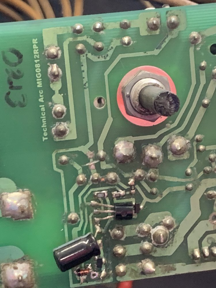

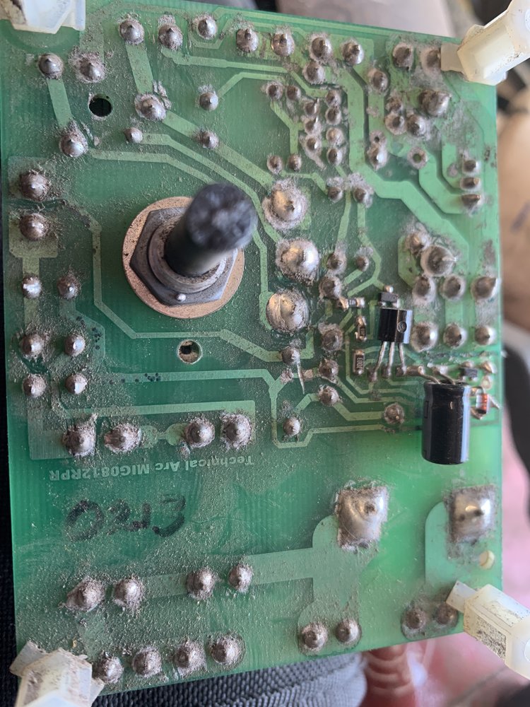

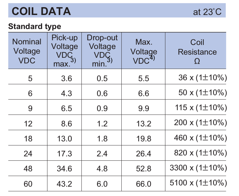

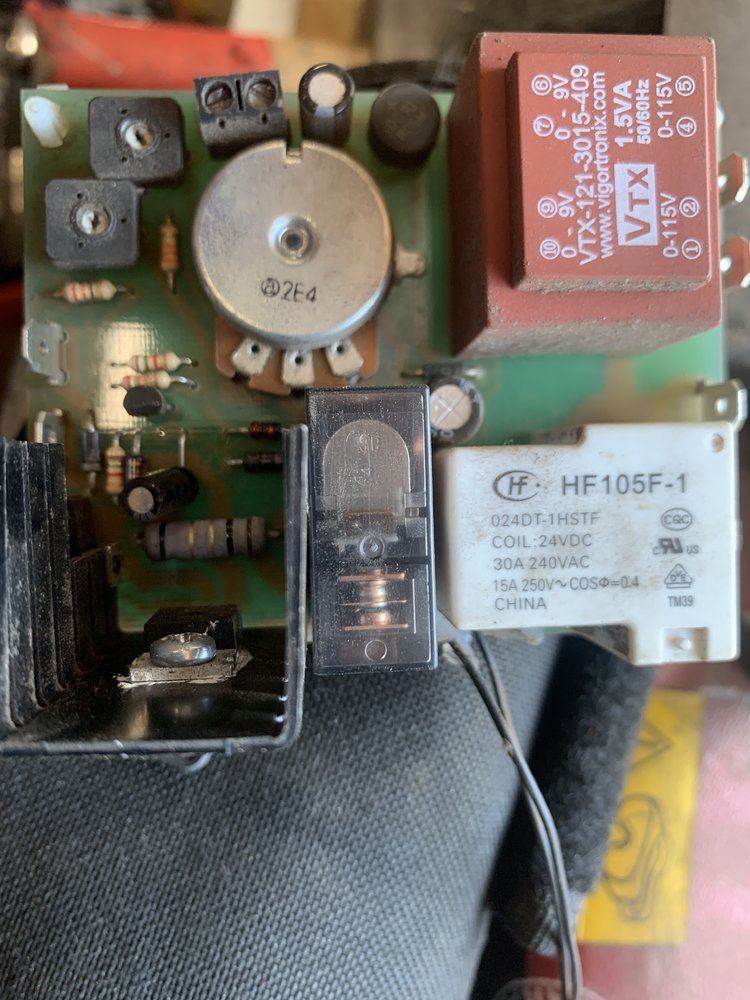

Porta185 from Steve at Weldequip back around 7 years ago and it has been faultless, however, whilst using it this week it stopped working. Fan and light are both on and checking the continuity from the torch switch all seem well. I have removed the control board and the relay coil seems to measure around 1.5kohm. I was expecting less.
Can anyone verity what I should expect at the coil and if it seems right what’s my next check.
Back of the board looks grubby but I wouldn’t expect issues from that.
