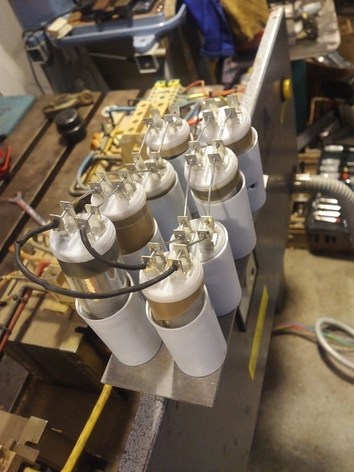

When I acquired this converter it had duff caps on the phase-shift stage (start caps were and still are OK)... I replaced them with some generic Chinese ones off ebay and it has lasted a year.
It has a hard life powering a load with a poor power factor (inverter Welder with no pfc circuit) so that has probably killed them.
