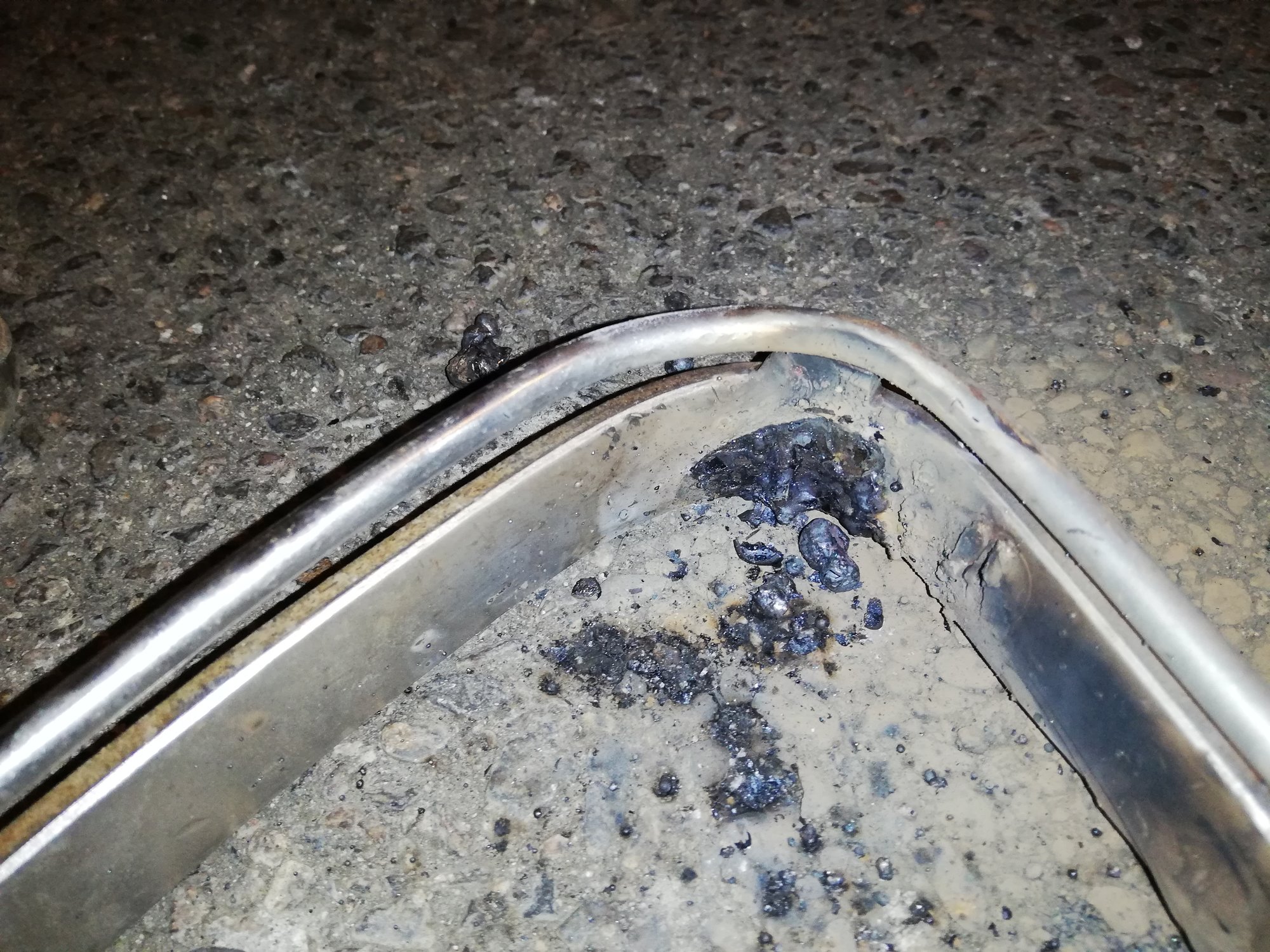

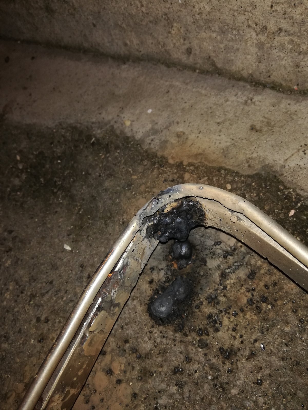

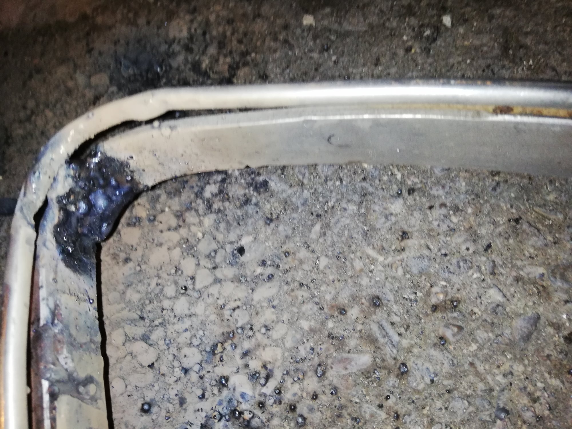

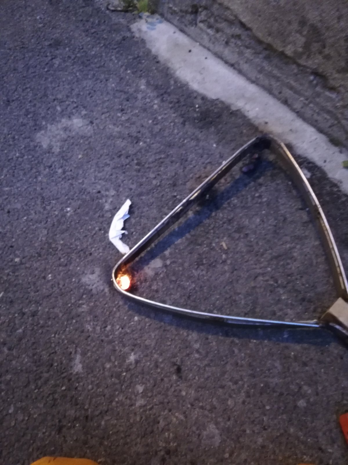

Today I had to work on a kind of rack for clam fishing
Someone enjoyed welding on it making a big mess
I have to replace all the teeth on it
So I had to remove the old
Had difficulty to remove a "weld " in a corner where the grinder won't come in safely
I don't know why but the grinding wheel doesn't do nothing on this thing so
I figured out a way
6013 2.5mm 180A an compressed air got the job done
