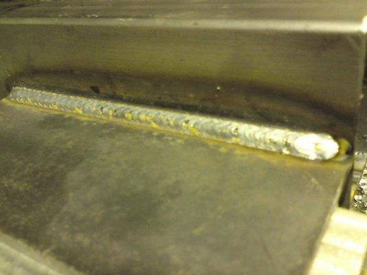

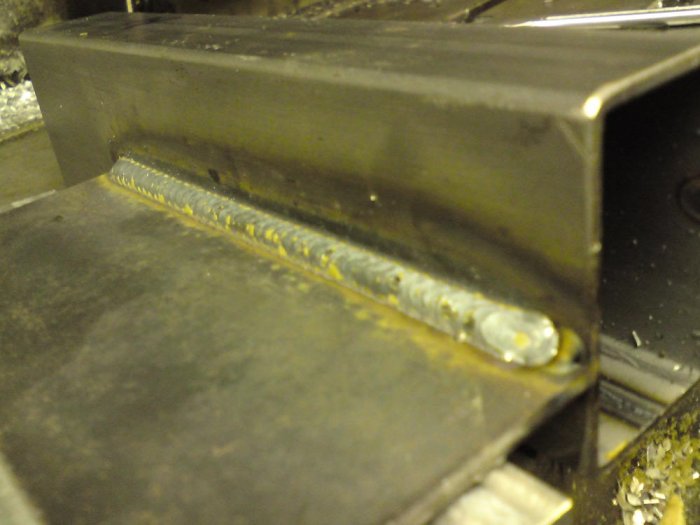

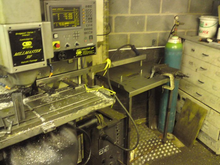

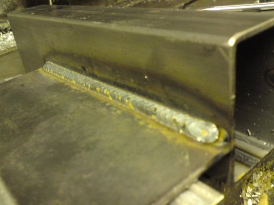

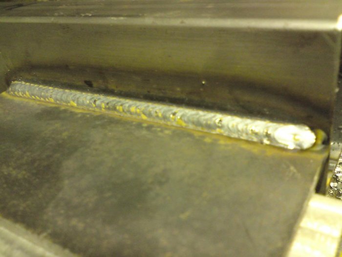

Rob, who/what switches the welding torch on & off ?
These results are so consistent, I'm thinking that if I built or bodged a jig or guide or slider to move the torch ( e.g. print head carriage of a redundant dot-matrix serial printer ... ? ), my own cr*ppy welds would be improved.
Nice results and nice setup, but surely that machine can be earning more money doing what its supposed to be doing?
I'd love a miller like thatHardly poormans welder
Indeed, but I only have to undo 2 bolts to remove the support arm and it's back to normal
Nice welds
No danger of any stray current leaking back to the electronics? Or even the EM "buzz" from the welder?
