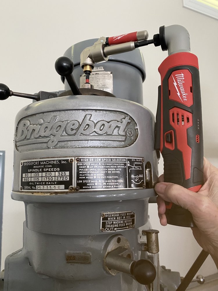

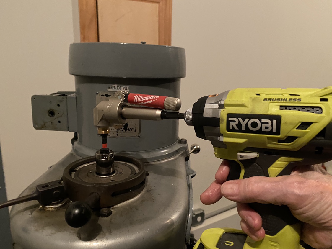

If you are tired of fumbling around with wrenches on your Bridgeport drawbar, you might want to consider this. I use a Milwaukee right angle impact driver and an additional Milwaukee right angle attachment for the job. It's easy to drop it on the drawbar with a 3/4" socket overhead without looking. The trigger of the impact driver rests against the Bridgeport head, and a bit of pressure activates it.

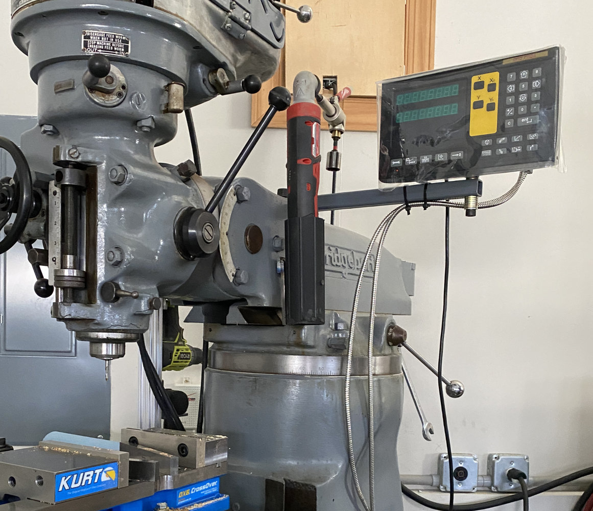

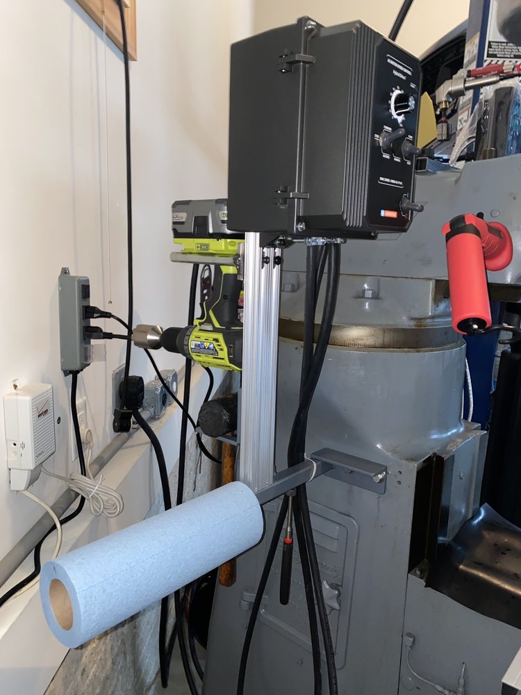

I keep the impact driver in a little holster on the side of the mill next to the DRO. A rubber hammer is kept on the extruded aluminum support for the VFD on the opposite side. The impact driver has plenty of torque for tightening and loosening collets. When you think about it, a regular power drawbar is nothing more than a permanently mounted impact driver. It's not great, but it does work, and is better than trying to manipulate wrenches with oily hands.

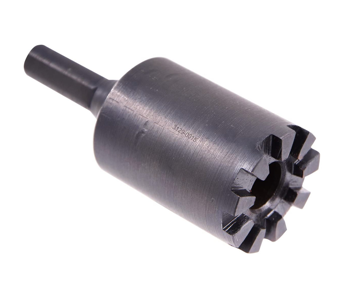

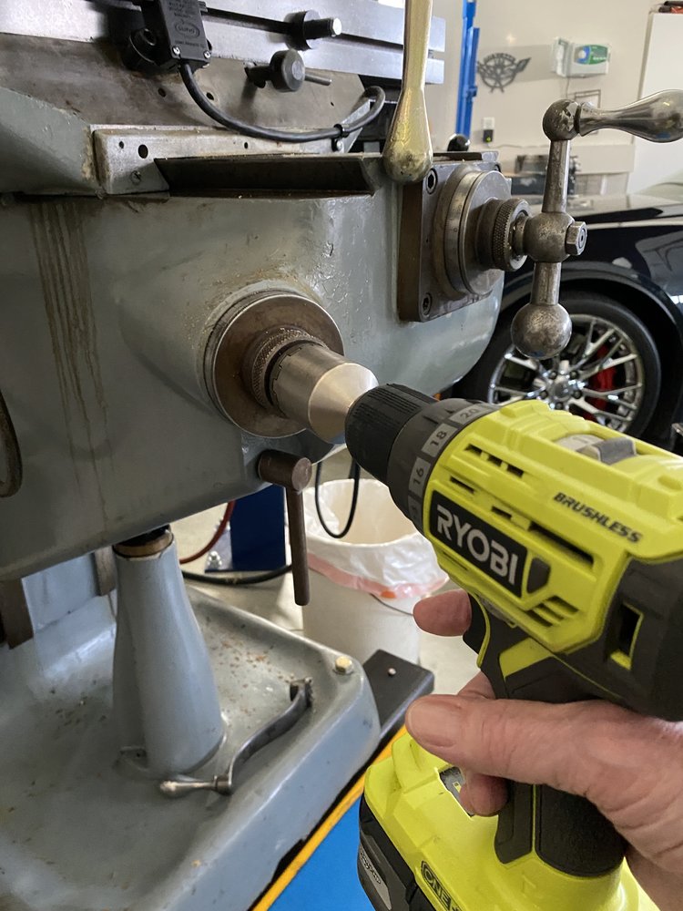

Also, you might want to consider using an attachment on a cordless drill to power the knee on your mill. The socket, for want of a better word, is available from Amazon.com. Here is the link: drill attachment. This works perfectly with a 1/2" cordless drill.
