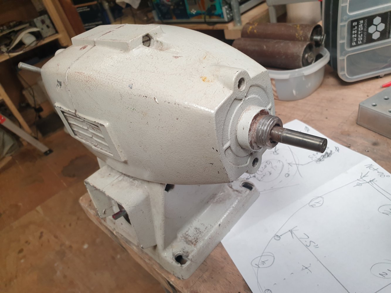

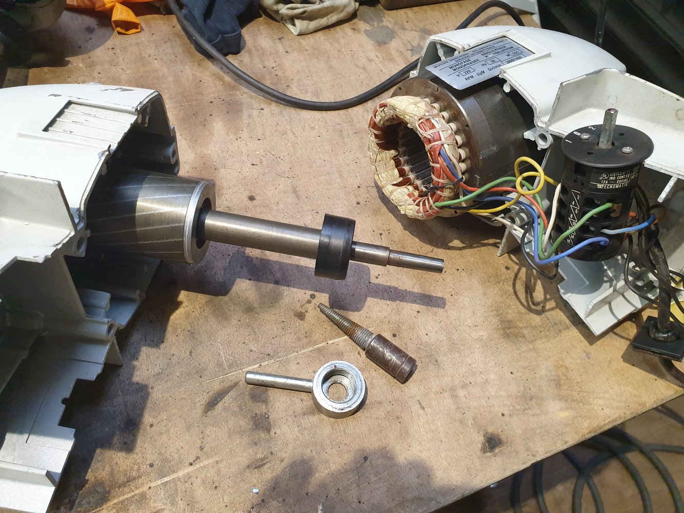

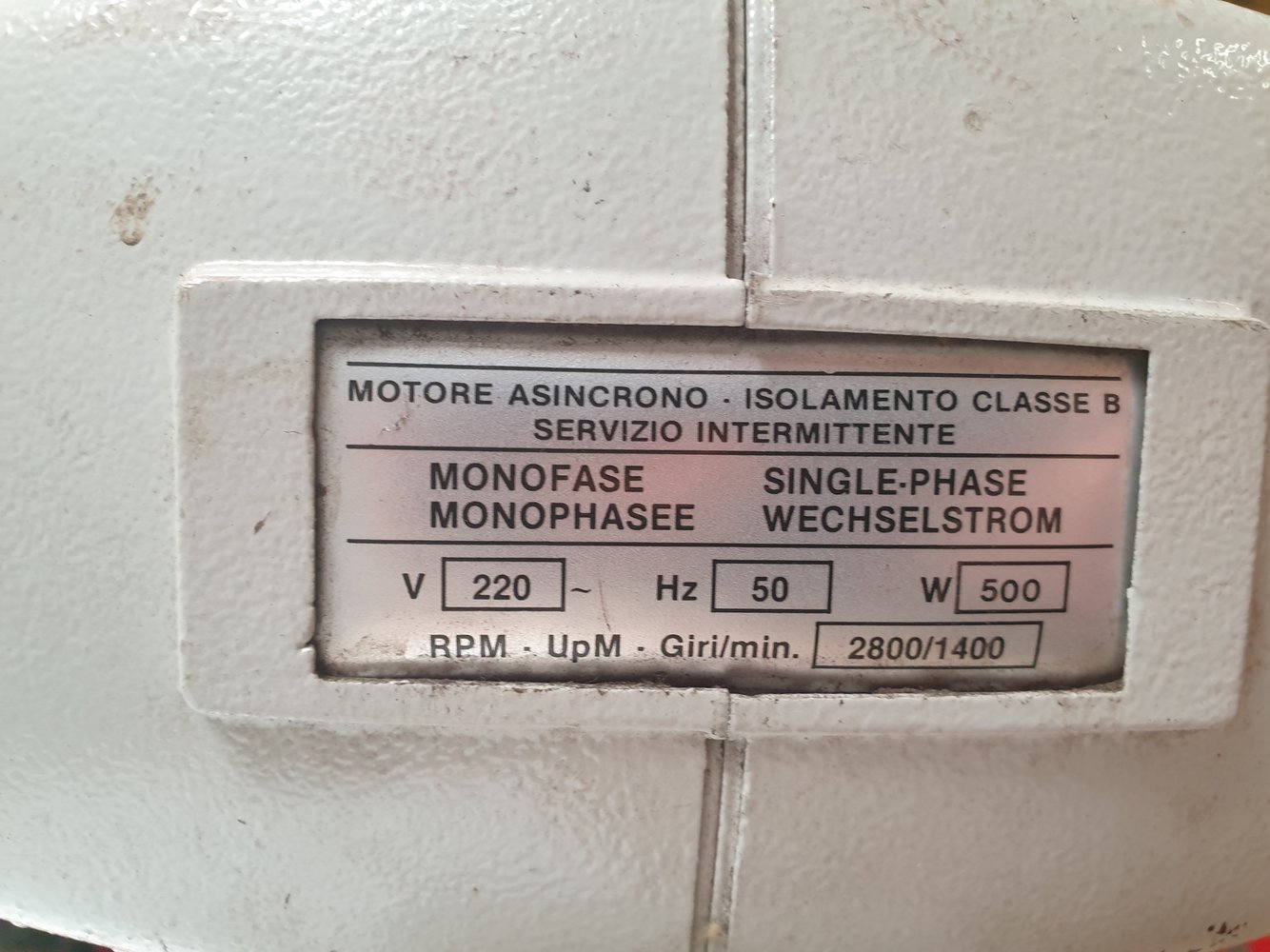

I picked up this polishing unit yesterday and all it cost me was a 2 minute detour on my way to work.
It's got a 500W motor, 2 speeds and seems to run nicely.
I have plans to put a deburring wheel on one side and some kind of grinding wheel for HSS tools and drills.
I tapped M8 threads into the pairs of holes to mount a guard and also a coolant catcher for the grinding wheel.

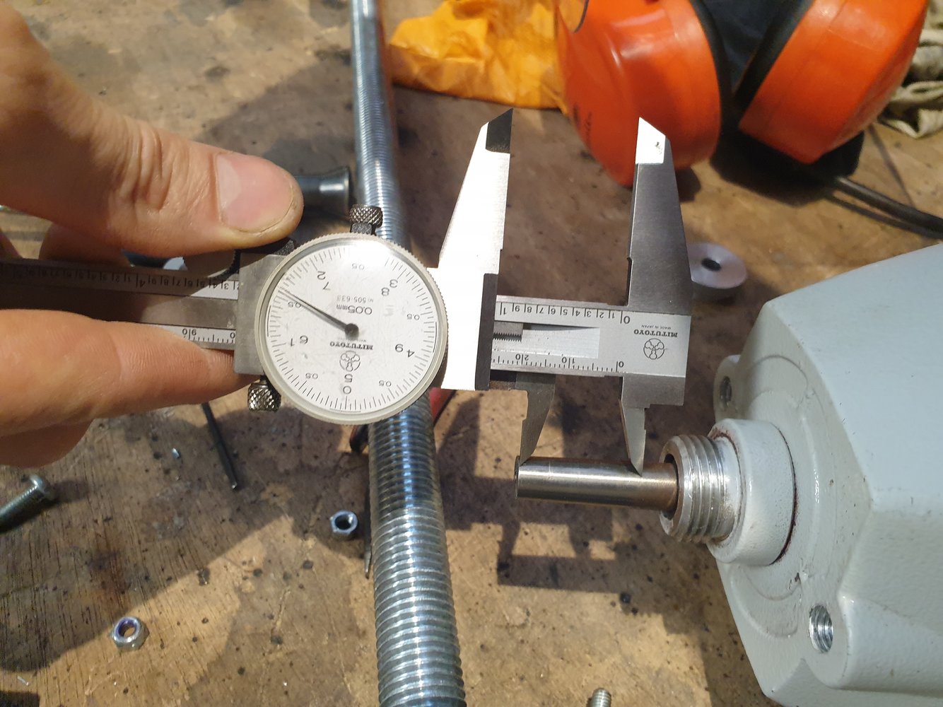

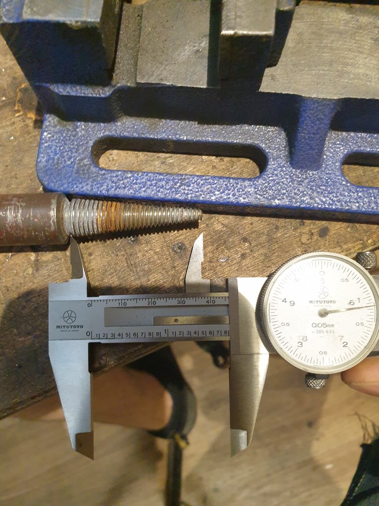

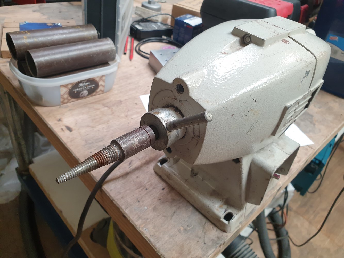

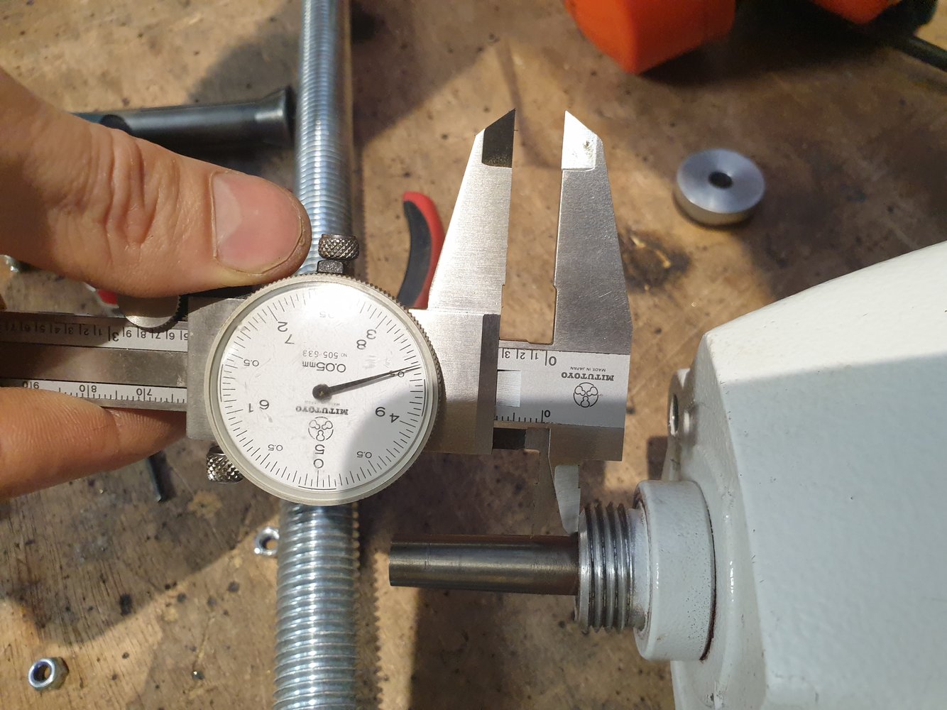

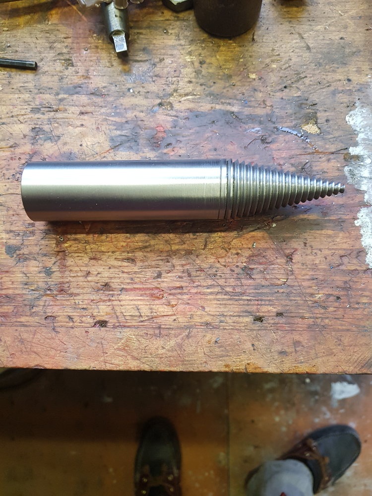

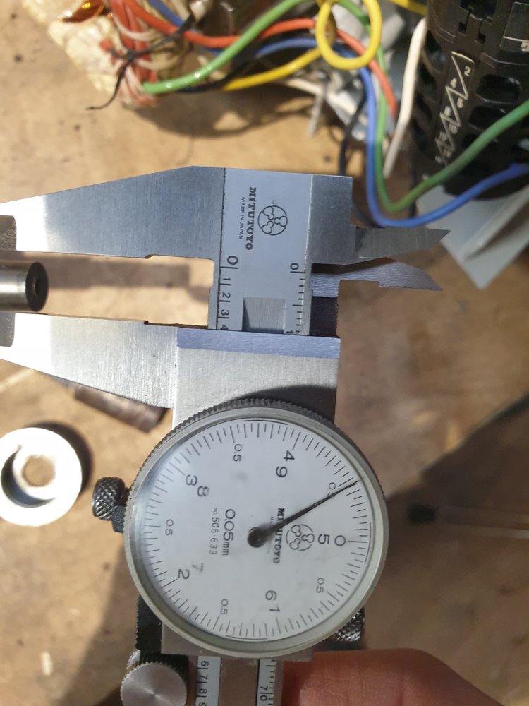

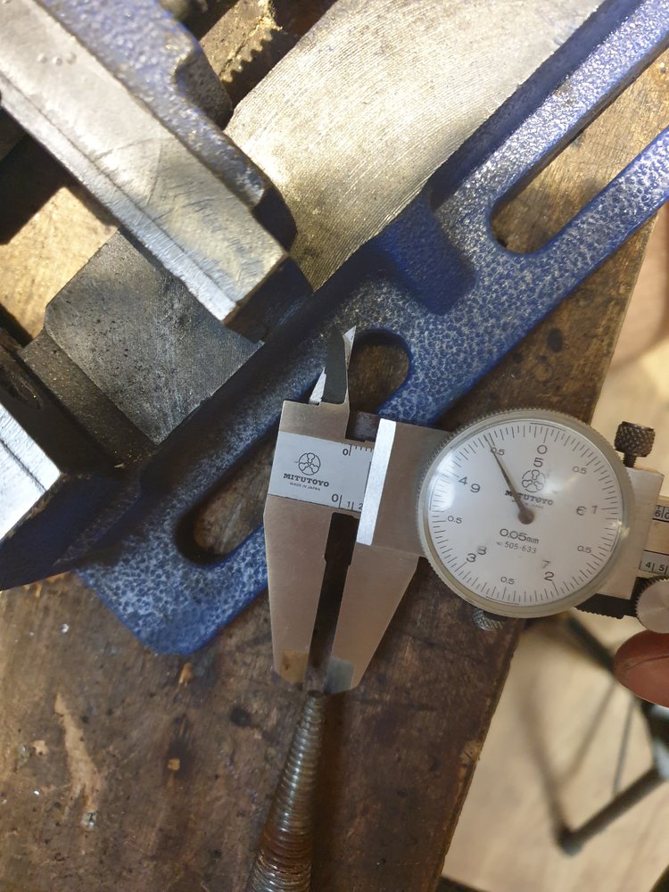

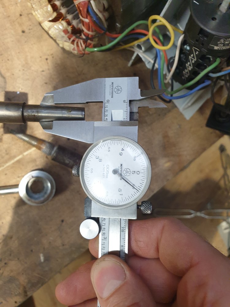

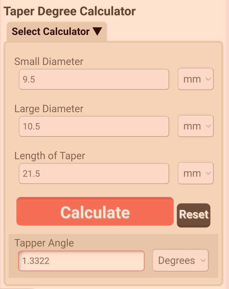

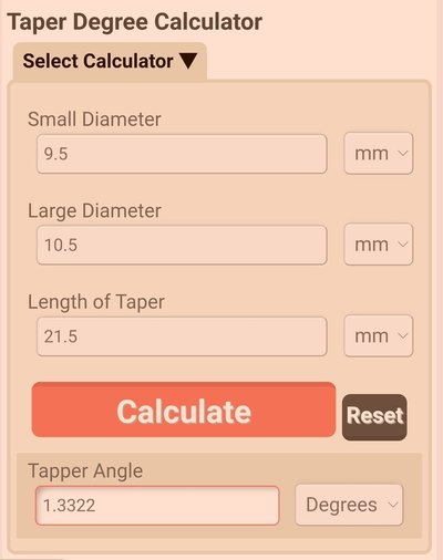

It only came with one of the spiral spigot-y things and I'm not set up to be able to make one of my lathe. (Let alone having the skill to do the taper.)
Anyone know what they're called and if they're a standard size or custom to each machine?
