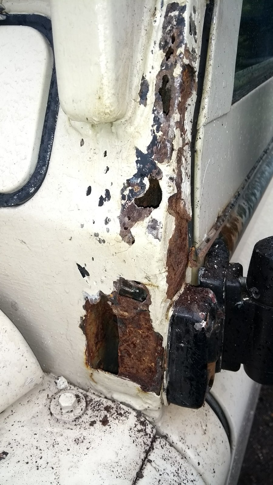

So we start with this beauty that is on my profile pic...

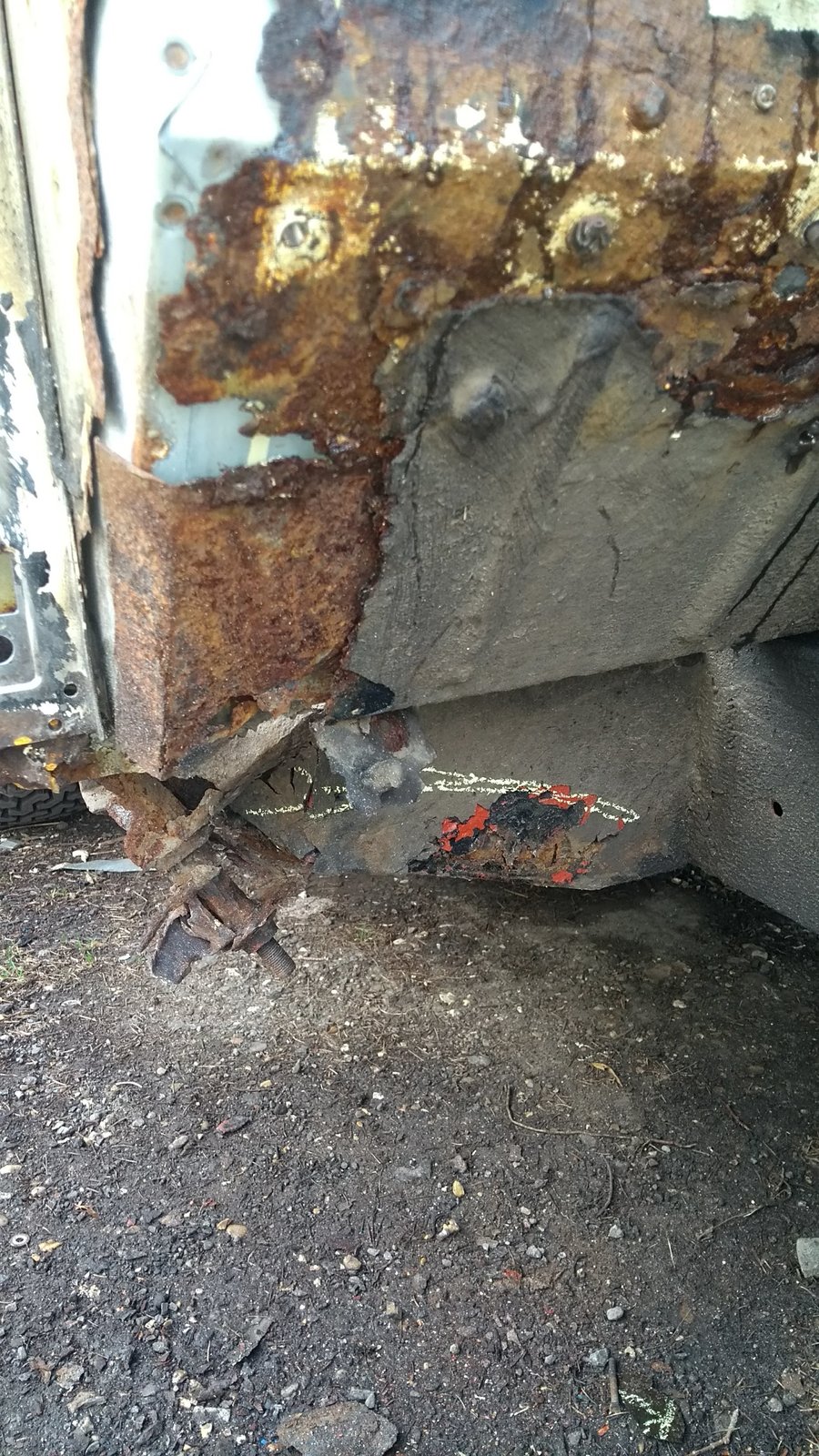

And then start poking at a "rusty scab......"

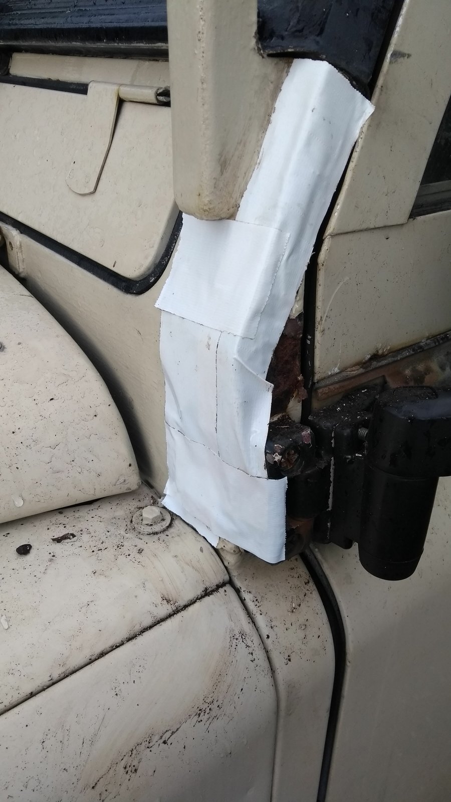

But it's ok because I "fixed" it and this genuinely made it through the MOT:

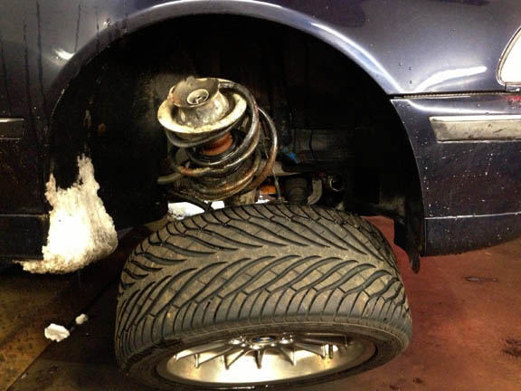

But the MOT Gods weren't so bad at their job and noticed this small issue....

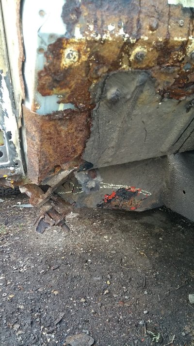

I had already belted the foot with a toffee hammer at this point - it wasn't this bad initially (hahaha)
I love that the PO put in a new footwell inside the old one - classic.

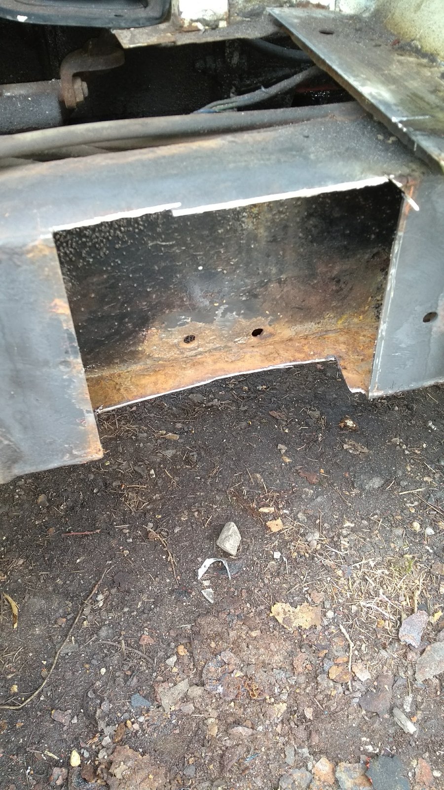

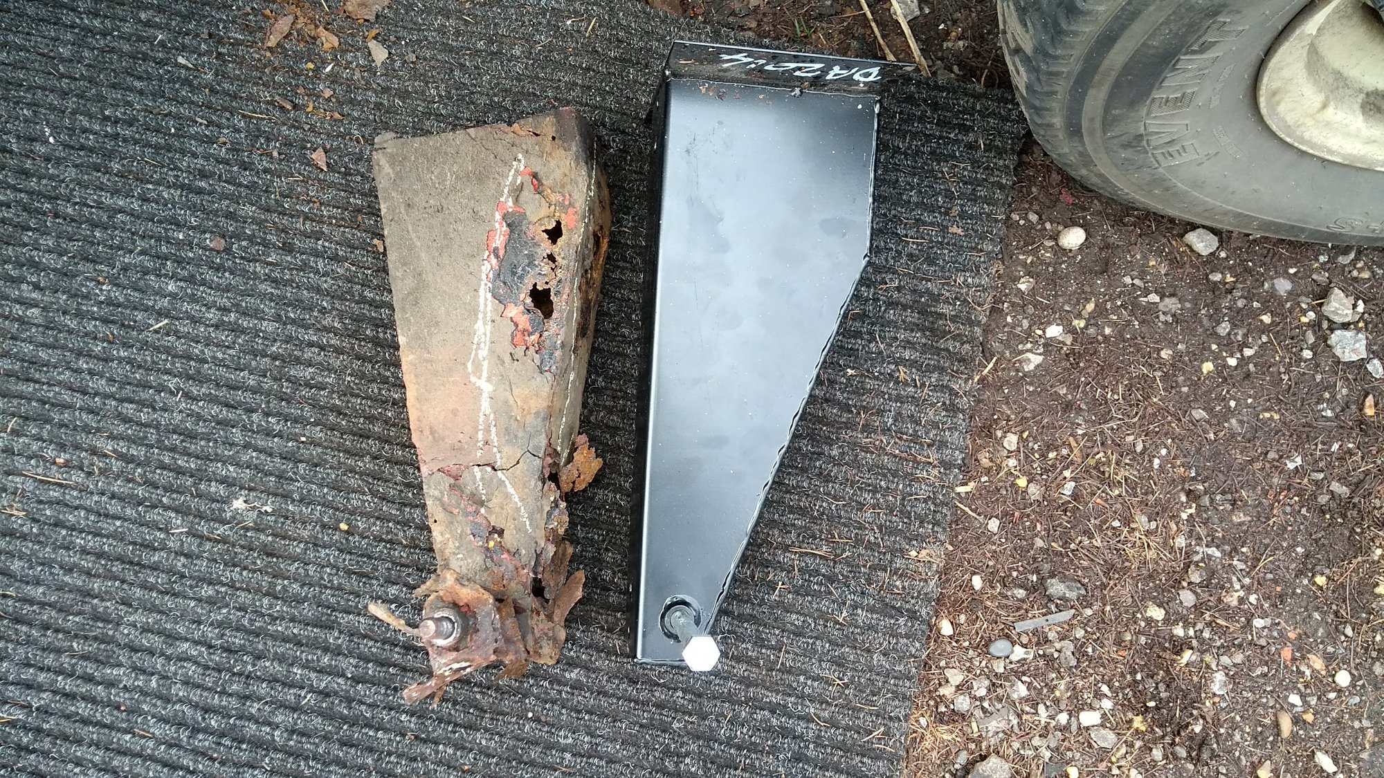

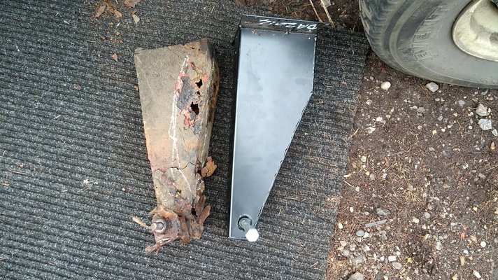

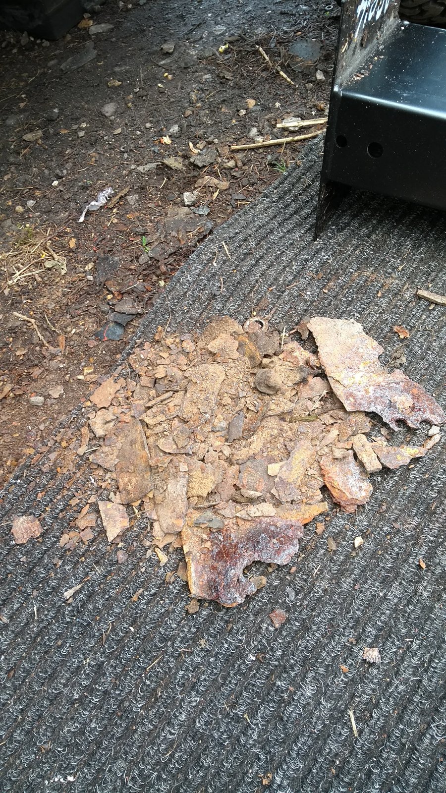

But the outrigger was a shadow of its former self:
She could almost be considered a Lightweight with the amount she has lost and there is plenty more where this came from:

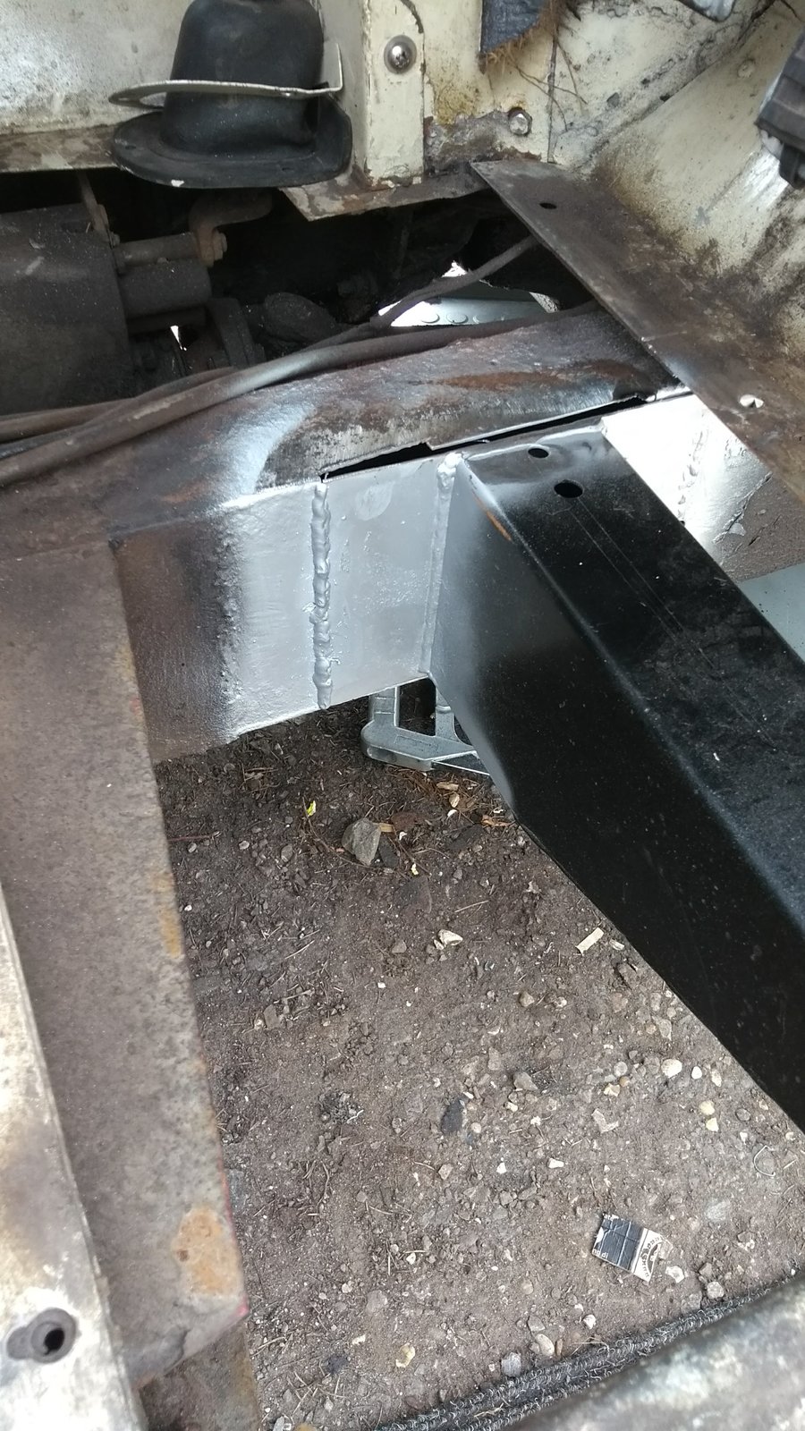

Berkshire Geoff and the Search for the Not So Holy Steel:
It's not pretty but it's solid (more so than before anyway and fully welded btw)

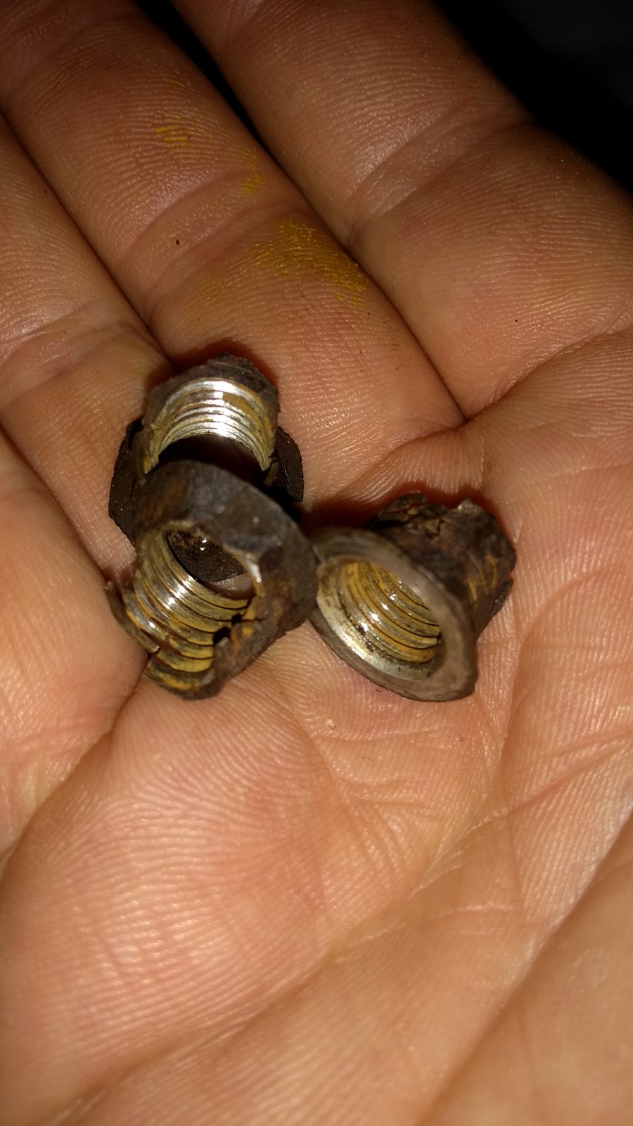

So happy with all of this I started to look at the brakes that the MOT tester said were "inefficient"
What he actually said was not something I could publish on here.....!
But what I then found was the source of some of the death wobble and weaving that she is prone to - Who'd have thought that such a small amount of play would cause such a problem...it's only a few thou'........
