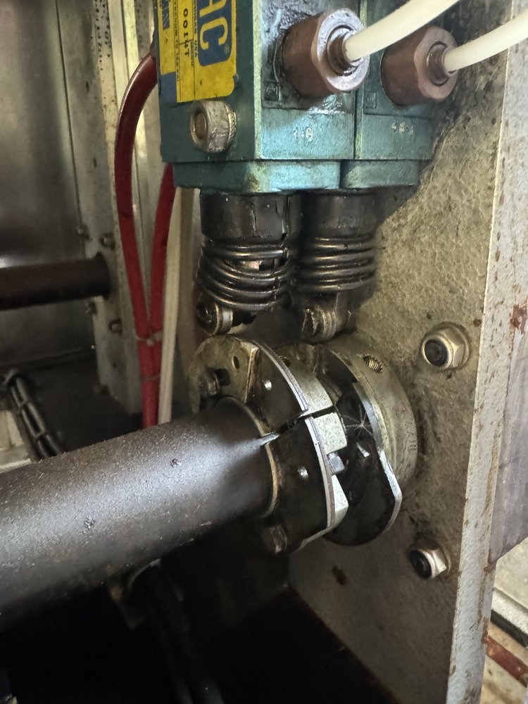

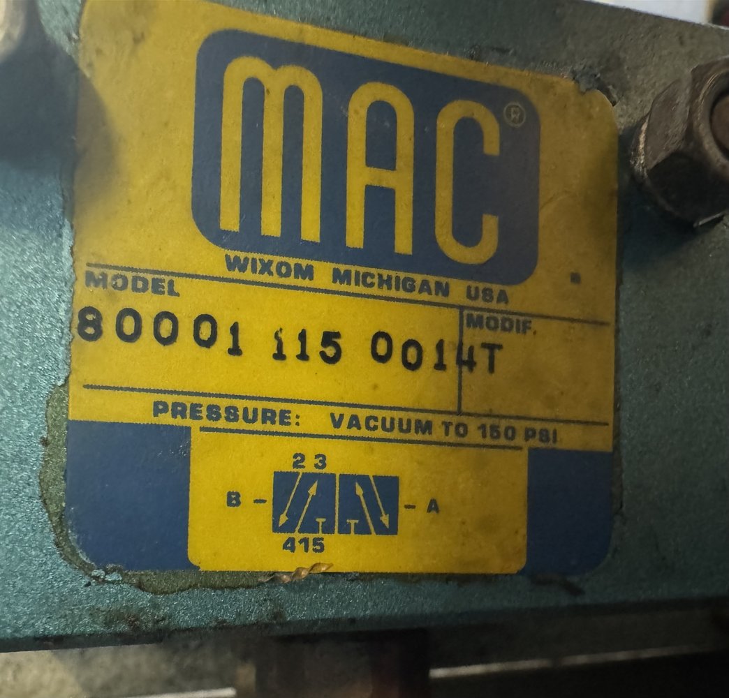

Thanks i'll fire off an email to them now.MAC Valves are still going:
Their UK distributor is:
Homepage - PSI Technologies
PSI Technologies is an innovation-led engineering solutions provider, offering bespoke design, manufacturing, and control system services across industries.psitechnologies.com

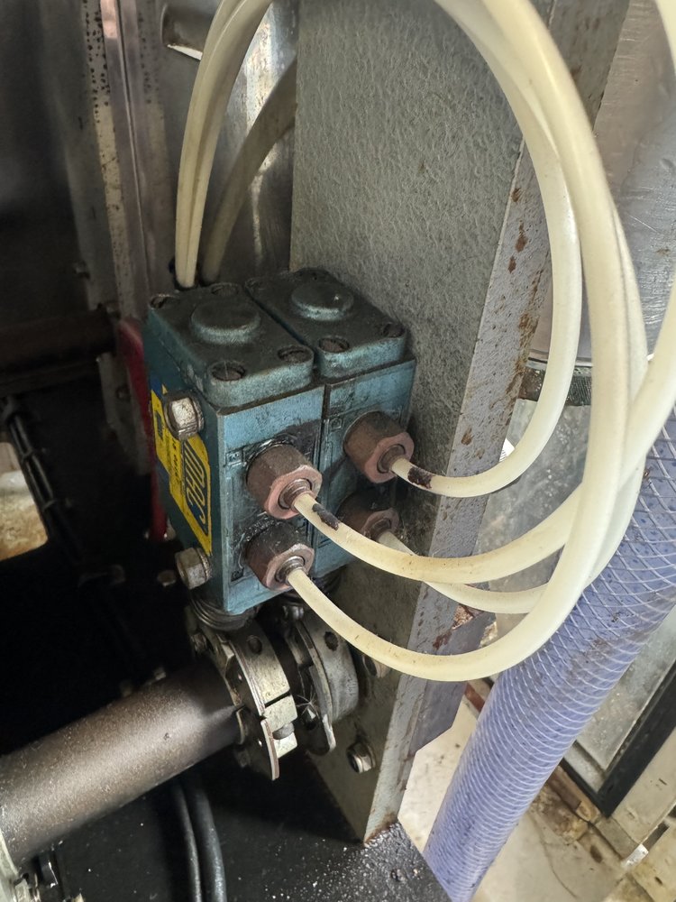

Any replacement would require the same movement characteristics as the original (simple example fully open to fully closed over 1/2" stroke of plunger) or you will need to fiddle with the cams.
Please look at their 1800 series as they are available with a cam roller actuator.
