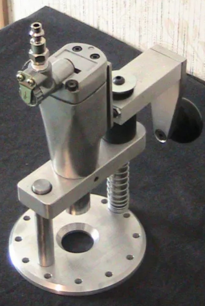

Sprung captive is bestIf it's not a captive drawbar, then you need to modify it so that it is with a surface to press against when unwound.
Some stick some dont.If you are pulling/holding the impact gun down onto the drawbar so the socket goes over the hex on the drawbar, when it unwinds, it cannot go upwards. Hence, the collet can only go downwards. I was under the impresion that R8 collets (unlike Morse taper ones) are non-stick.
