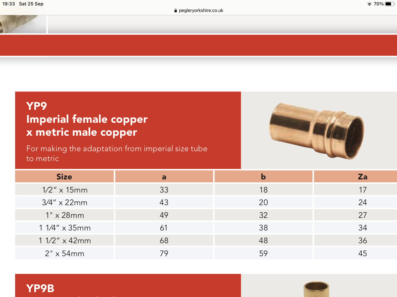

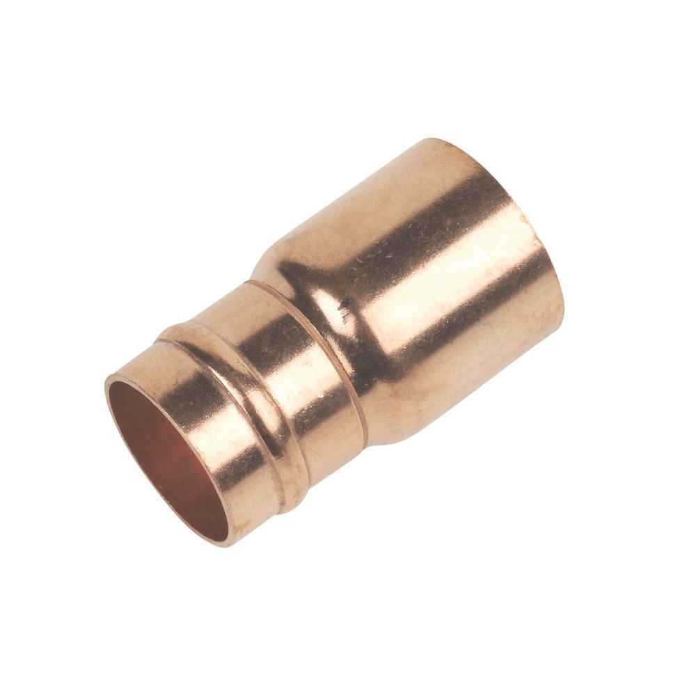

Hi,
Is there a copper pipe 28 to 22 reducer which would have a solder ring at the 22mm end (22mm inside) and the 28mm end would be 28mm outside.
What is it called.?
I have surfed screwfix and Toolstation but it isn’t clear what the sizes denote. Otherwise I would have to buy 3 metres of 28mm pipe to use 4 inches of it.
thks
