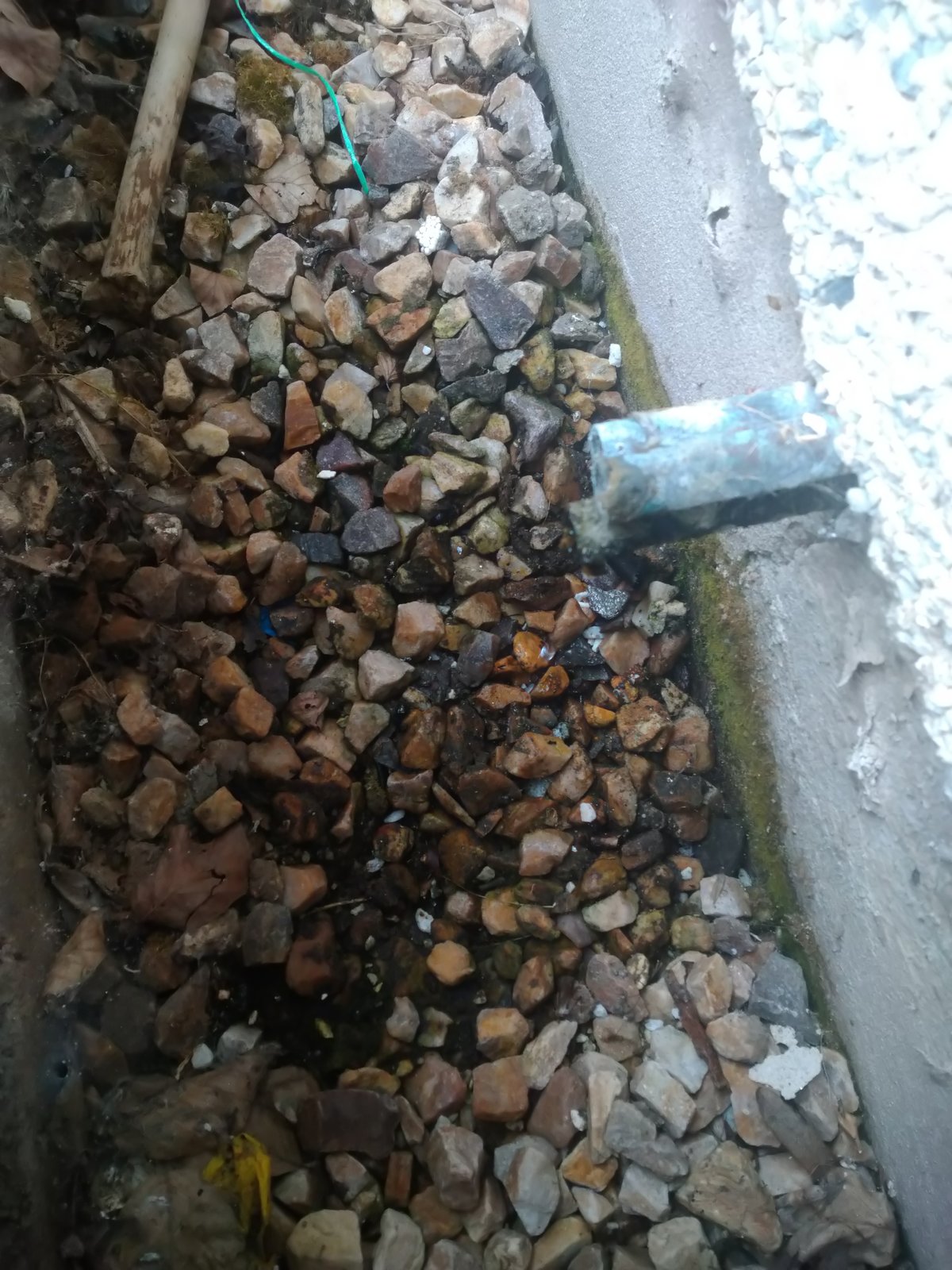

If the drip stops when you turn the water off at the mains, then the drip must be controlled by a valve (open) or by a faulty ballcock, the next thing I would try is to turn the hot and cold water on in the bath and see if the drip stops, as the flow of water would be more than the flow of the drip.
You could then turn off the cold, see if the drip starts, then turn off the hot and see if it starts to drip, this may give you some idea which system is more likely to be at fault, Hot or cold..
Also check the overflow from the cisterns n the toilets, although this would be noticeable as they would be on constant filling, altrhough a slight drip may be unnoticed.
If you live on an estate where the house were built by the same builder and to similar design, I would ask a neighbour if you could have a look and see wether they have the same pipes coming out of their house, if they do, then contact the builders and ask their advice, they should be able to explain the reason for the pipes and give you some idea where they go too.
A few years ago I bought a house for my daughter, brand new, after a few days the bottom toilet started to leak, on close inspection I found they had not put a overflow pipe in, and the ballcock was faulty, hence the flood.
Yes!Just get a can of expanding foam on it - that'll learn it proper.
Wos up with the hot drain discharge side nut?The mystery is solved. Took up lino as getting new flooring down. Found this hatch. The valve nearest the top of the picture is the cold water system drain. It was open a tiny fraction and so was passing the amount seen.
Tightened this up and leak stopped.
Working towards the right the valves are cold drain, hot drain and c/h feed and return drains.
