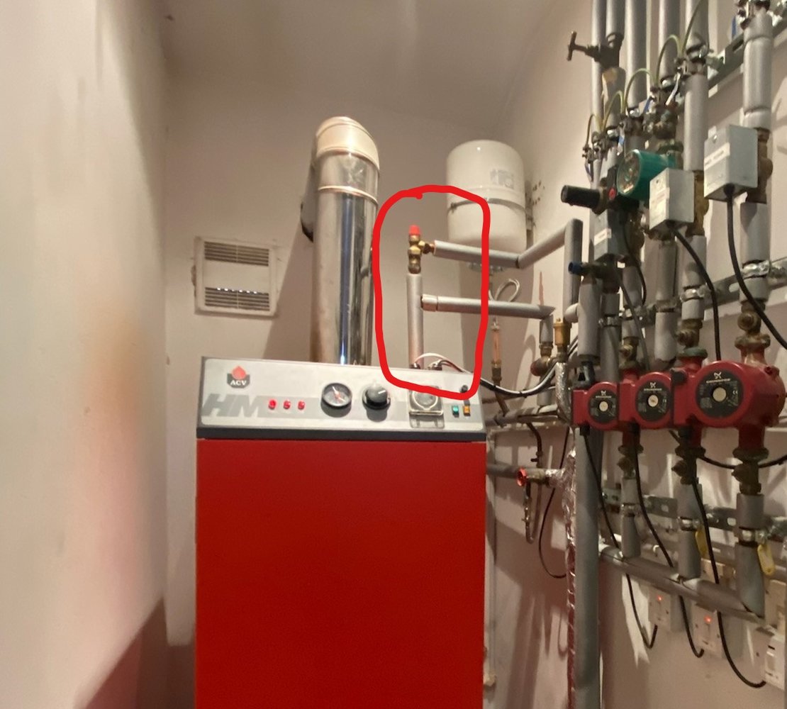

This is my boiler its at least 10 years old ( I bought the house 3 years ago), the temp & pressure valve keeps leaking after around 8 months, its leaking on temperature, its set to 90 deg c and 7 Bar. the tank temp says its 85 as recommended in the manual. the temp seems to be regulated ok, I am thinking the valve stem (200mm) should be in the tank not high up at the top of the hot water outlet. I have fitted a check pressure and temp gauge since the pic and it says the temp is close to 100 deg C , but a infra red temp meter says 75 deg C (out side of pipe).
Any G3 plumbers out there?
As there is only one outlet I am not sure where else they could have put it.
