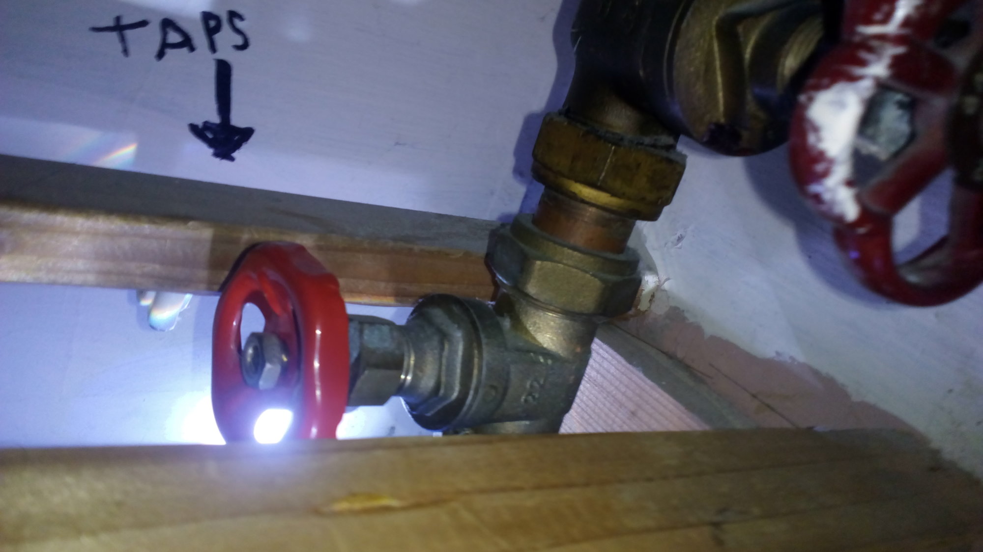

u never see an outside tap leakTurn it off, if you can undo the nut between the body and the red hand wheel then you can pack the shaft with PTF tape, you need to wrap it round and poke it down and do it all back up. I've done my stop cock and an outside tap in exactly the same way recently no issues since. The only difference on mine was the securing nut was a male and yours is a female
