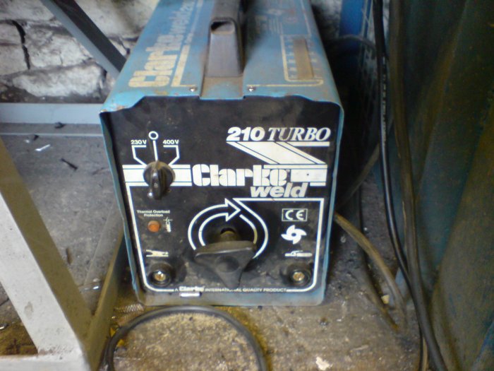

loking into fitting euro plug? ( right name?) or similar to my arc welder so i keep cables tidier when not in use.
how hard is it to do?

I have used these 10-25 dinze panel sockets on a clarke arc welder. The cable inside the welder fitted onto them pretty well, the holes in the panel needed a bit of enlarging. And the welding cables then need the corresponding size fittings.
They worked well.
The next size up dinze connectors seemed to be a bit over the top for the size of the welder i had.
A pic of it...
... are you using the supplied cables or have you uprated the electrode lead ?
