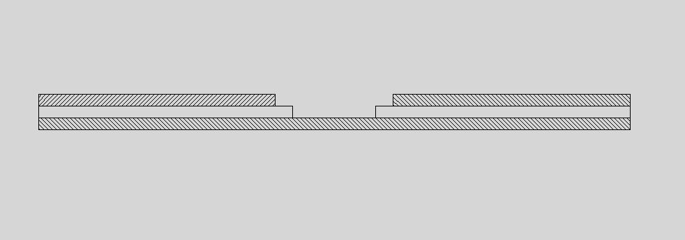

D David56 New Member Messages 7 Location London england Feb 10, 2021 #1 Can I weld three prices together by drilling the top two at the same place then clamping and MIG welding all three at once. or an I weld three pieces together using a hand held spot welder like the Sealey one
Paul. Moderator Messages 7,047 Location Northampton. UK Feb 10, 2021 #2 yes you can do a triple plug weld with mig ,tig or stick, drill the top plate a little bigger than the middle then you will get the edges of both of the top plates.
